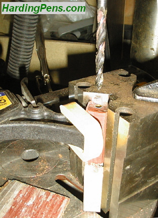

I use this set-up. The V block is held down by a single clamp in the corner so it can be pivoted in or out to get the drill to align with the blank center. Another quick release wood clamp holds the blank to the V block.
