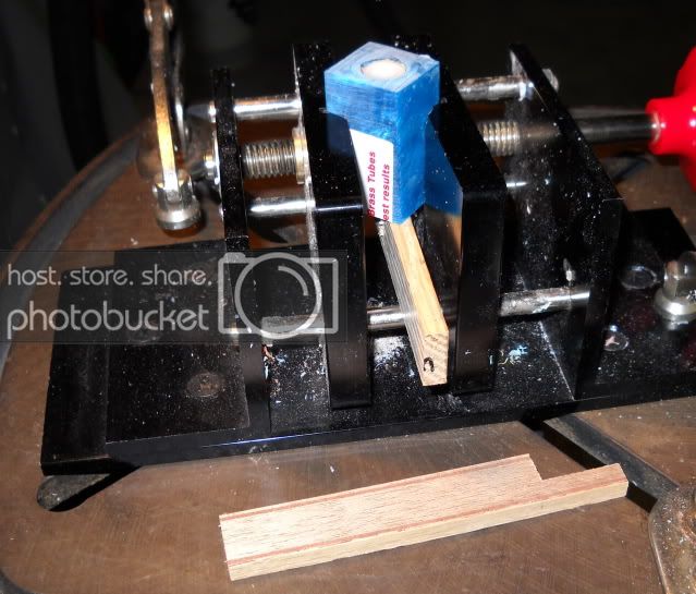

Put a small wood block under the blank you are drilling, you just need to catch a corner of the blank, make it thin enough so it won't get in the way of tightening the vise.

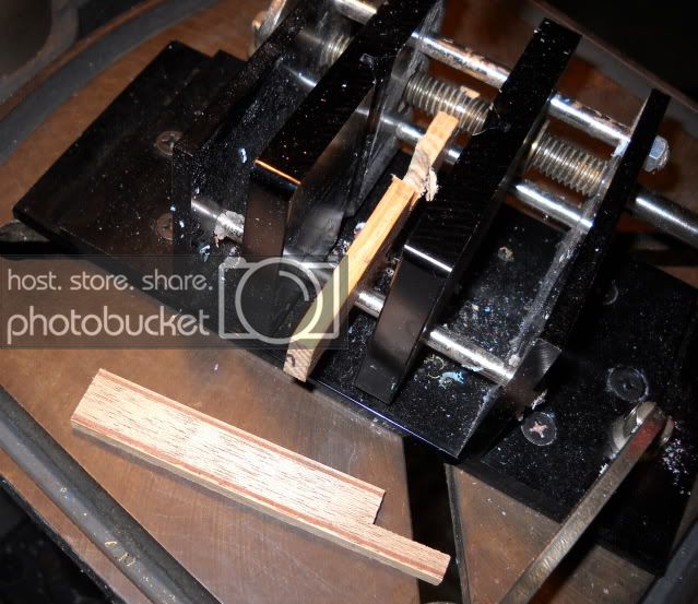

+1 I have probably the same vise from Lee Valley. I made up several 1X stock strips 1/4" thick X 4 1/2" long. Cut a 1" notch at the end to fit under the vise screw. They do fall apart after milling a lot of blanks so I recommend making several at a time. On mine, the connecting nuts tended to become loose so I recommend some red Loc-tite on those -- mine has been smooth and trouble-free after I did that. I drill blanks on the lathe but do all my milling on the DP using this vise.

Vises like this are not meant to grip anything tightly enough to hold them in place. Even with my PH vise, I use a block(s). This does two things... it holds the blank in place, but more importantly, it provides a backer helping prevent blowouts as you drill through the bottom of the blank.
Billy has it dead on -- I use small blocks about 1/2 inch square to set under the pieces to be drilled -- with either the old vise as shown or the one I got from Paul. You do want to have the bottom supported to reduce/stop splintering (and very very sharp good quality drill bits helps hugely).
The vise keeps alignment --- the blocks keep elevation and you do not need to tighten very much - on a good day with similar sized material, I leave the vise a bit loose for production runs.

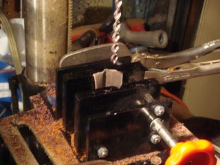

Try Sand Paper & Double SIded Tape
Hi:
I have the same vice. A friend suggested using double-sided tape and 80 or 100 grit sand paper stuck inside one side of the "V" groove. Here's aphoto.
