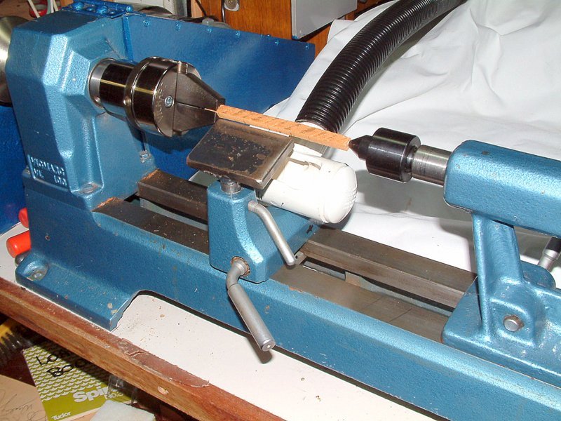

My new Vicmark Penjaw chuck set up on my VL100 Lathe for Hair Sticks, Lace Bobbins.
Peter.

That looks like a nice heavy duty one and similar to PSI. I have a Jet midi lathe so will have to look for something that is compatible.
