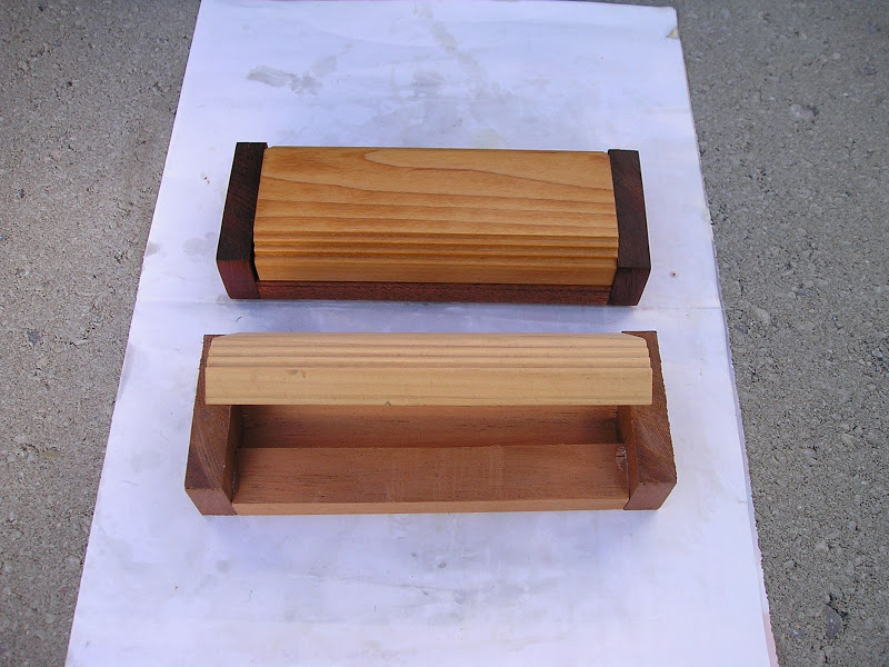

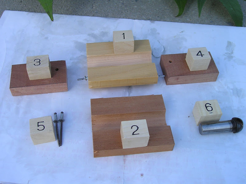

Here's a quick and effective way to make your very own pen case. You take the time to craft your pen masterpiece and then you go and buy a cheap pen case? I don't think so. The pictures make it very simple to follow, but if you have further questions or comments post away and I will try to answer. Enjoy building your very own.
1.Top of pen box
2.Bottom of pen box
3.Left side of pen box
4.Right side of pen box

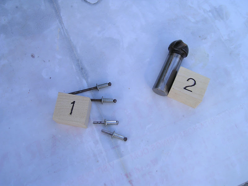

5.Pop rivets(2) used as hinges (high tech stuff, eh:wink:)
6.Core box router bit
Very nice Peter! Looks like the top and bottom can be routed in long sections and cut to length.
This is a great idea to use for those bigger fountain pens that are too big for many of the standard pen boxes.
Thanks for sharing.
Thanks for sharing.
Thanks Brad. You're correct, rout the top/bottom in one "continous" strip and then cut to length of the pen.
