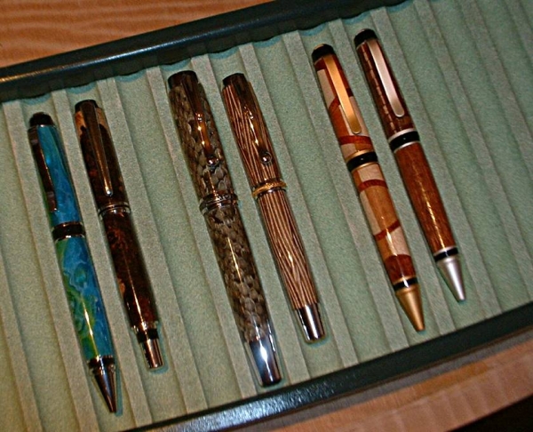

If you have a router table, this is simple:
I took a 3/4" thick X 1-1/4" wide long strip of poplar and routed a groove in the center of the strip using a 3/4" core box bit.
After routing, I cross-cut the strip into pieces of the desired length.
I glued the strips edge to edge, built a frame around them, then flocked the bottom where the pens go.
I used light green flocking and painted the frame dark green.
Here's a pic:
I did exactly what Gary shows. But I added elastic banding in the middle with a hole through each ridge. Worked great, displayed pens in "palettes" of 15 each.
