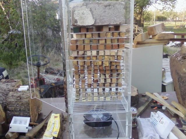

I got the drying box built. 12 X 13 X 31. It will hold up to 150 blanks. The plexiglass was free ( stolen from a dumpster) Special acrilic glue $6.10 Sirenge for glue $.60 piano hinge $9.80 total cost $16.50 plus four hours of my time. I will lt you know how it works.
Mark
