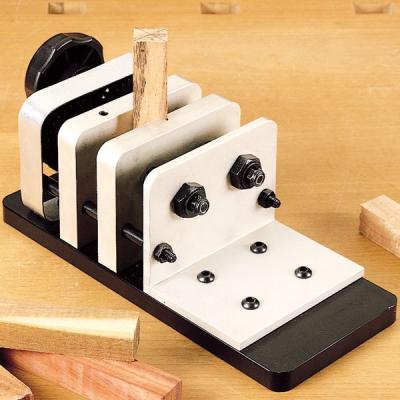

I have tried ordering the above item from a UK supplier but he is out of stock and is being forced to oder more then he can afford.So he does not know when he will have any in stock.
I beleave that these items are inported from the U.S.A. Does any one know which company this is and there address or an alternative supplier in the UK or the U.S.A.

There are a number of versions of the drilling vise. Does it close by turning a screw or have a toggle clamp and arm you press down ?
http://www.woodcraft.com/images/Products/151256tmb.jpg
These are the versions sold by
Pen Vises PSI versions
Don't know if either ship International.

Is this what you are looking for?
Pen Blank Drilling Center Vise at Penn State Industries

Sorry for delay in responding have been unwell for dew days. This is exactly what I have been looking for, I have contacted Penn State Industries asking for shipping costs and am awaiting a reply. Thank you for your help in this matter. Will keep you informed of our progress and talk later about pen making as I am new to this trade.

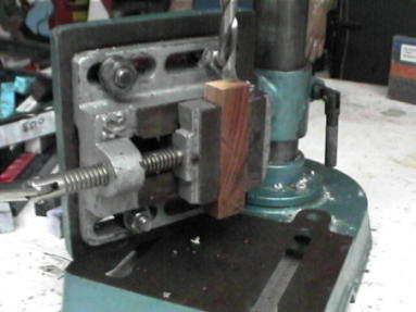

If you have a drillpress and a vise you can turn the holding plate up, then bolt the vice to the plate, use bolts that are a good fit in the slots, use a set square too true up the vice, or you can square up the vise using a drill bit, just mount a drill bit into the drill chuck move the vise around to grip the drill bit, then do up the vice bolts. By using the vice on its side it will let you drill any size blank for any kit, and it will have a good straight firm grip, also good for longer blanks and easy to clear the sawdust.
