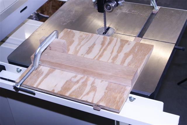

Looks good, James. I put a stop block system on mine as well, but I used the more traditional method of extruded aluminum channel. Bought it on sale at Rockler a few years back and decided now was as good a time as any to put it to use. However, I only used 1/8 inch plywood for the base and I'm now wishing I'd gone to 1/4 like you did. I'll put that one in the lessons learned file!
3/4" would be fine. Very sturdy. Easier to countersink the screws from the bottom. I always use what I have lying around. I am a pack rat when it comes wood. I always end up using a small scrap from another project. I love being able to complete an idea from start to finish without going to the store.

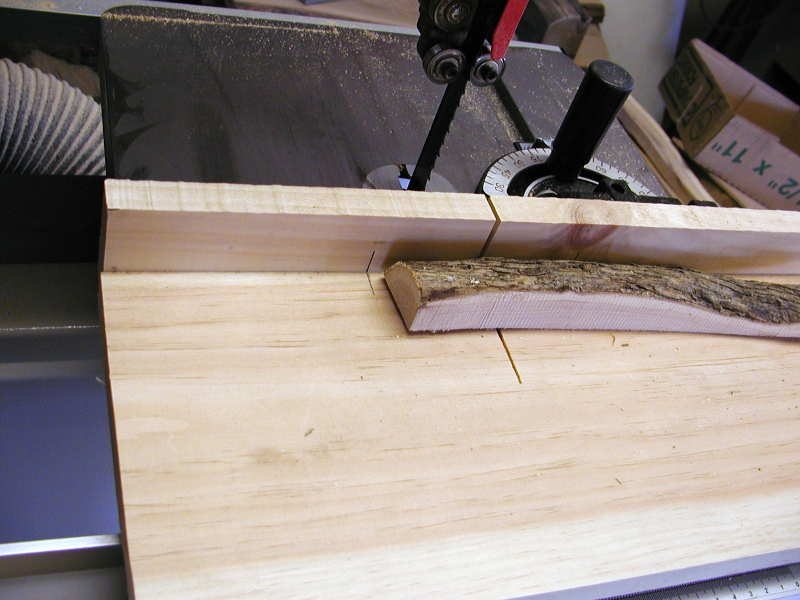

Originally posted by WoodChucker
<br />Very nice, it looks great! Mine is more on the simple side but it works good.
Looks great Chucker! I like the stop block donw the track there. Another simple, but good idea. Nice looking saw too. Is that a Jet 14"? Nice wide blade. I am going to get a 1/2" blade this weak.

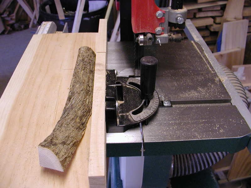

Purty little thing, Now this is not ment to put down anyones sled. But I really appreciate when a woodworker goes all out to make even there tools look like they put some of there craft into it. there was once a time when a craftsmans tools where there resume. when hand tools where all there where. and most people had to make there own, there where some mighty fine hammer handles and such. I hope to one day fill my shop with the same sort of advertisments. but I to fall prey to the ready made simplicity.
My band saw sled is opposite from all others. I find it to be safer and easier to use. The moving blade is at a safer distance away from you hands.
