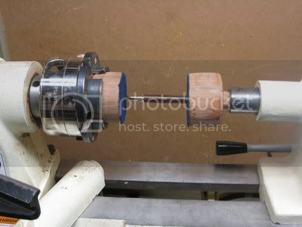

Turn a couple of wooden bungs, one in the headstock, one in the tailstock. Lock the tailstock and simply wind the bungs towards each other. Been doing it this way for ages and it works a treat.
Chris
I do the same thing. I turned two pieces of oak with a #2 MT that fit in the head and tailstock. It gives me complete control.
