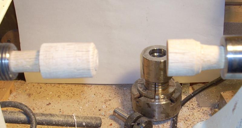

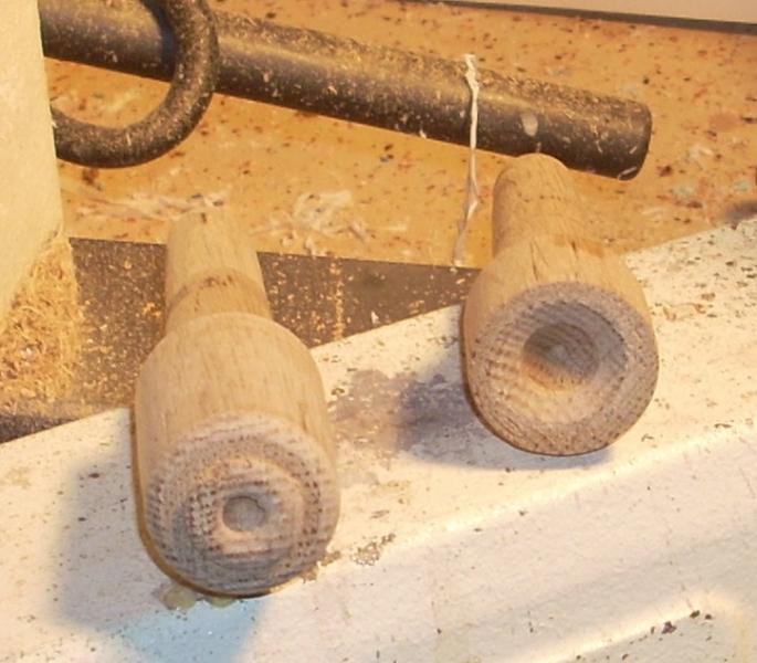

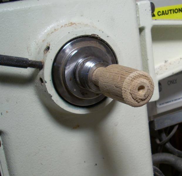

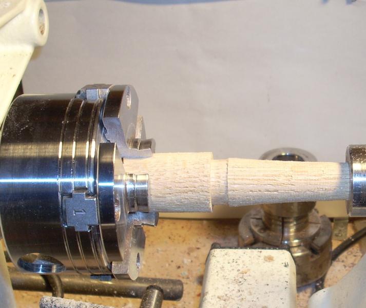

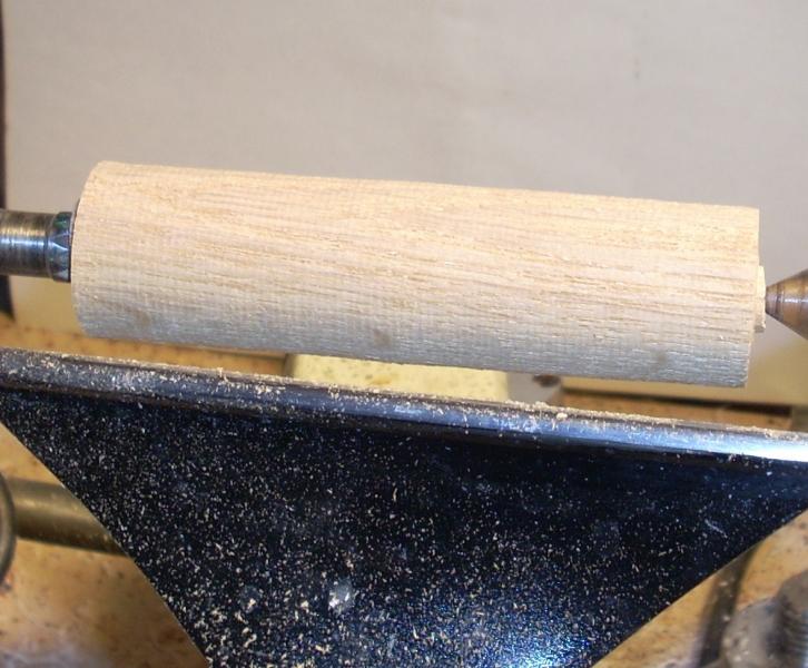

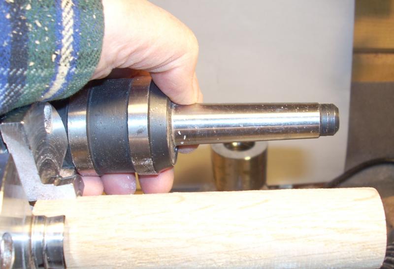

For years I have watched this forum, and though I love tools, I have a small pocket book..It appears others do too...If one thinks outside the box, our lathes are horizontal drill presses with Lots of length available..if one only turning pens, no need for a drill press.. When assembling pens I used to put the pen parts in my wood vise, but sometimes it would get slightly cocked one way or another, and cause me problems. So I decided to make my own pen assemblty pusher to save $ this way too...nothing fancy, just useful, takes 10 minutes and a scrap of hardwood...and uses the lathe to push. I have no clue as to how to insert pictures in a text so I will write directions and then send pictures
1. round hardwood blank
2. you want this taper
3. With LATHE OFF insert into morse taper in tailstock ..check,turn,check, turn
4.put in headstock & make a cavity that will hold a pen tip
5. turn 2nd center just like first except for the face. Make a cone shape here for pen parts to center in
6. Two centers in their morse tapers..lock down tailstock and use tailstock crank and gently & with great control push parts together
I was making myself a new set of these this morning & thought I'd share the method with you..I usuall get a hundred ( + -) pens put together before I spend 10-15 mins to make a new set....
enjoy saving your $$$$$$:smile::smile:

I think it was due to to the long term effects. If I remember correctly, the bearings are not angular contact bearings in most wood lathes, so they do not stand up to the direct pressure from pressing repeatedly.
I don't know if there was any direct evidence of this, or just conjecture. It's enough of a worry for me to look for other methods.
Really? pressure on the bearings?? What the heck are you pushing??? most of the time one can start by hand & just needs sending home...
As far as the pressure on the headstock bearing. drilling on the lathe would cause the same issue but still seems to be a growing method. I have not tried it yet but it sure looks like you woudl have great control on how far you have pressed parts such as the transmissions.
