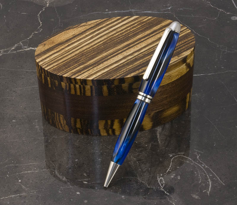

Today I tried an Easy Rougher Ci1 carbide chisel on an acrylic pen blank.
I was stunned at how well it handled, and how smooth the results were. I went straight from the Ci1 to Micromesh finishing.
The black and blue acrylic would show any flaws... and I see the Ci1 as my new go-to tool for acrylics.
It's shown here with a little zebrawood/walnut bandsaw box.

If you look closely at the reflection, you can see the top of the pen. The bottom of the pen's reflection blends into the box's reflection.
It's amazing what one can do with a little dab of wax <s>
