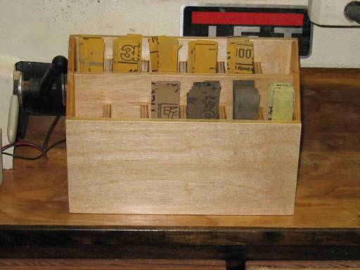

I precut sanding paper into strips. The MM does not go into this box.
