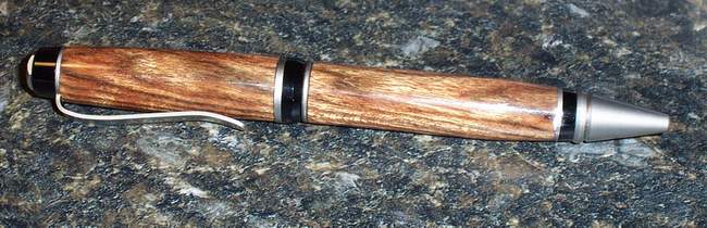

I put together this cigar pen tonight and when I pressed the nib adapter into the barrel a small piece of paper towel got pressed in with it. How to I get it apart enough to pull the paper out?
