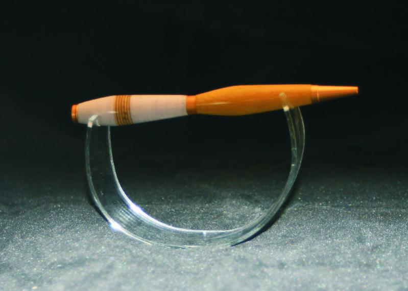

Alright guys, here it is. I call it Bumble Bee. Picture didn't turn out so good, but I like the way the pen turned out. It's a combination of Yellowheart, white copy paper, and brown matte board. BLO and CA finish to 12000.
Yes you need to give us a close-up. Looks like it turned out well. Was there any complications??? Does this lead to other ideas??? I seen somewhere here a person do a pen from cardboard but I could not find it. Thanks for showing. Nice work.
