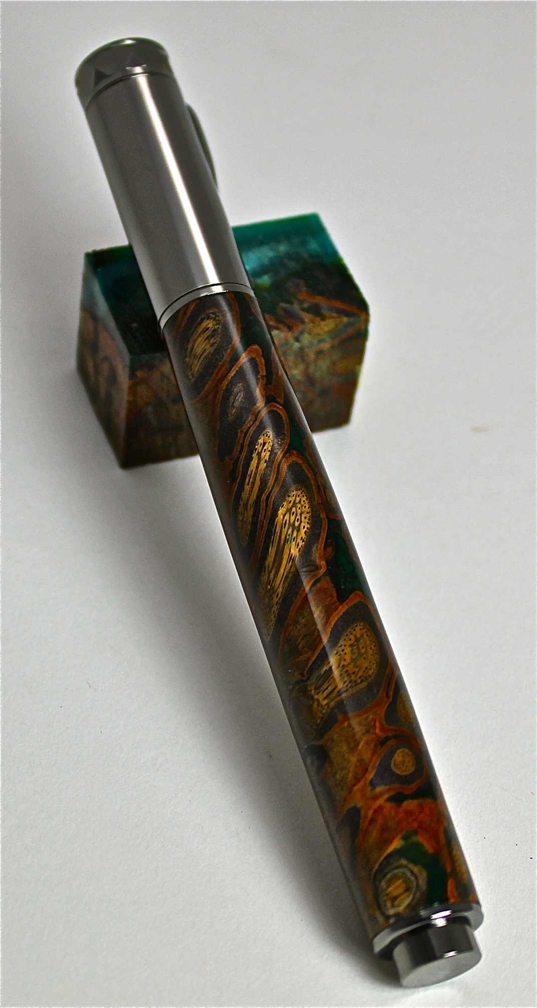

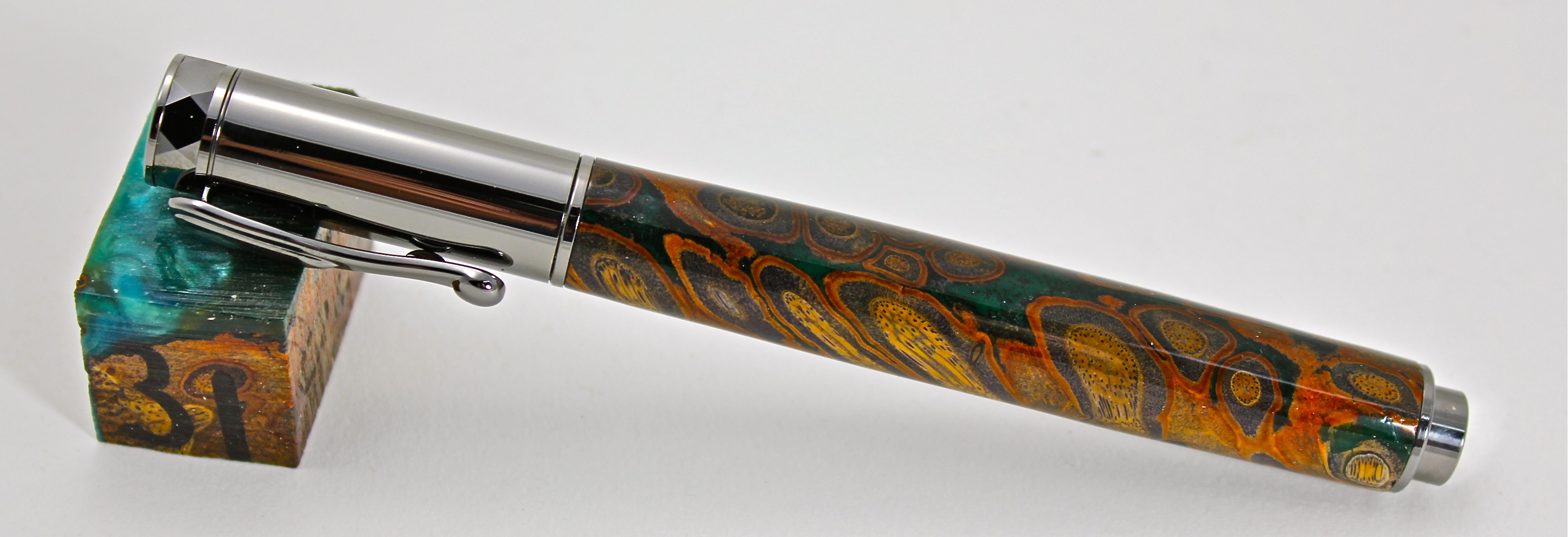

I finally have started something I have been wanting to do for a long, long time. Make a few pens from blanks from "friends"... for myself!
I have had some blanks from George (Robutacion) for several years, and wanted to wait until my skills got better, and my time available got better.
So, drilled. Flooded the tube with thin CA to stabilize the inside. Painted the tube dark green. Waited 24 hrs, redrilled, and glued in the tube. Waited 24 hrs. Sanded the ends on the lathe with R Herrell's jig. Put some CA on the cleaned ends. Waited 24 hrs. Turned and was applying CA every 7-8 passes "just because".
I rarely use a CA finish for any of my pens, but based on what I had read, it seemed appropriate here. So, 8 coats of thin, waited 24 hrs. Then final sanding, 320-600 dry, 800-12000 wet. Polished and waxed. For me... I am happy! Now I have a nice carry pen to think of all things Aussie!!!
Cheers Mate!
Thanks George.
The code on the blank was #31, so I believe a Palm Root Resifill
NOTE: White specks... my camera lens LOL!

I haven't seen of of those finished for some time and yours is a beauty...!
You certainly took no risks with the material, those extra couple of steps and a few extra minutes of work, make all the difference.

Cheers George. Thank you for filling in the holes in the story! This pen will not be sold... so having the rest of the story is very nice!
I have quite a few more from you, so hopefully they will appear on IAP! Be well my friend, say Hi to Merissa...
Mark
Really looks nice, Mark.
I have some nice, special blanks from George also that I've been holding off on until my skills improved enough to do them justice. I plan to try a couple of them soon.
Hi Edgar! I was very hesitant to turn this as it is a "one-off." But, with the steps I took and some care, it went well.
The most challenging issue was the CA finish (which I did feel was needed) but it is one that I do very rarely, and have not spent the time to learn adequately. What I did was very simple and basic, but worked OK. I had no issues with getting the blank off of the bushings, etc... and the wet finish/polish went fine.
I am proud to have this pen in my personal collection! George... Thank You!

I'll give George (Robutacion) all the credit! All I did was turn it round. It is an interesting blank. Dark, to normal light, but very vibrant under bright light. As I stated, I typically do not use a CA finish, but here it was appropriate and worked well. Thanks for the appeal!

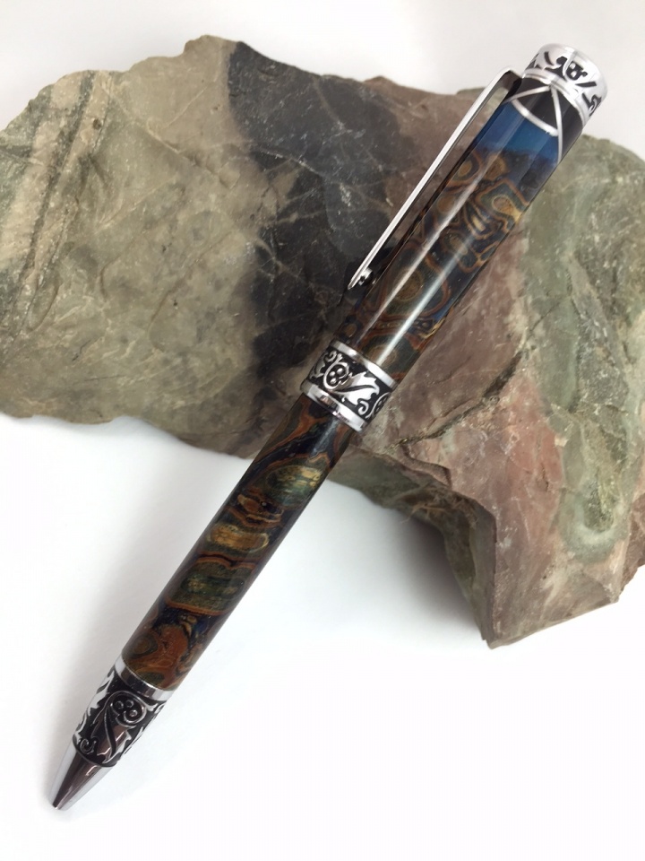

George,
Here's one of three pens I made from your beautiful palm root resifill. They created quite a stir at my Christmas open house/ pen show. Thank you for the back story on the material. I'm going to pass the info along to the purchasers.

Eric and James,
There has been a back story about the Palm root material/blanks written years ago, in fact, I have a few threads about the Palm root, it all was most interesting and once again, and after much work and frustration, I found a way to "tame" this beast, and made it possible to create blanks from it, have a look in here,

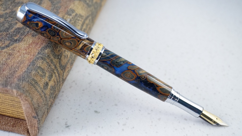

Here is my palm root pen.
Hi Kelly:
Beautiful pen and you segmented it also! Nice!!! I've looked at that segmenting, and will get to it someday. I remember seeing the pics of it.
And I can tell from your pic that your blank is very similar to mine - AND, that the pics simply cannot do it justice unless under bright light. My Zen looks very muted inside in the AM's, but under bright sunlight it's like a bulb went off. Very interesting blank. I enjoyed rereading George's thread of the tree and the background; makes the pen even more personal with the story.
