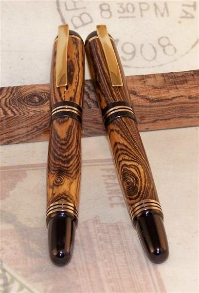

These are for an order. They are Bocote Gold Titanium Churchills. The blanks were cut from the board adjacent to each other so as to match each other as closely as possible. One is a rollerball and the other is a fountain pen. Like Cocobolo, you have to love Bocote!

Nice, I dont dig the kits but the knots in the lower part of the barrel seem to complement the rounded lower end.

Those are sweet - I like the match of pen style and the Bocote. The Bocote you have is superb!!
Add me to the list that hasn't tried Churchills but now needs to....gee, more bushings!! Do I get to buy more odd sized drill bits too??? Sorry, I didn't really say that! [:p]

Thanks for the kind words, Rick. I found that Bocote board in a pile of wood at a show in Harrisburg, PA, and have gotten some great blanks from it. Even better, I have only used about half of it!
Yep, you will need new drills, bushings, and a "B" mandrel to turn the Churchills. If you have done an El Grande, you already have what you need as the tubes, etc are the same for both kits. The only thing is that the drill recommended by Berea for the cap is too small. BB and Ernie at Beartoothwoods sell a 13.3mm drill that is perfect for the cap.
