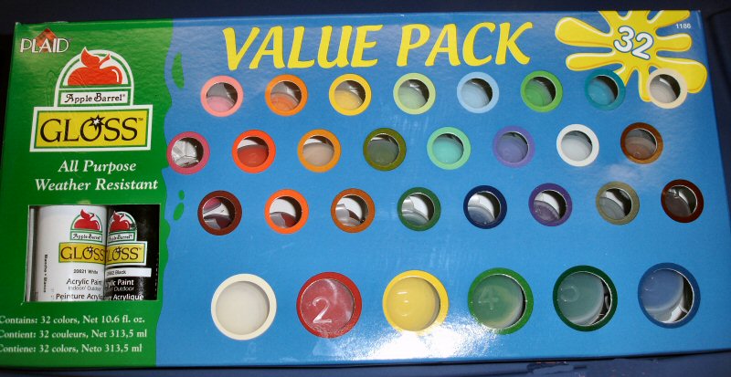

I've concluded you can do three things - paint the inside of the blank, paint the tube, and tint the epoxy. If you paint the tube, I'm finding that is the first barrier to cover brass. When I paint the blank, I paint a brass tube at the same time so I'm double-covered.
For paint, Walmart has a $9.95 acrylic paint set that are perfect. It cleans up with water, and includes 32 colors. Check it out.
You can purchase inexpensive brushes at Harbor Freight - like 30 for $2.99.
The Testor's is expensive, and requires paint thinner to clean up.
At my Walmart this paint set is half price for less than $5. I picked up 2 sets today. They said they are discontinuing them. Get them while they last.
