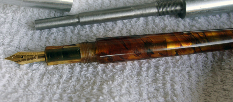

Yeah I think I'll just leave it as is. I posted this photo in the metal lathe section because I was talking about all the tooling I was working on for making the pen. In this photo is my partially completed pen and the mandrel I made on the metal lathe. I can see from the photo I need to sand/polish some scratches from the body.

For this one I'd definitely leave it unpainted. It looks great as is! Yea it needs to be sanded some more, but that's no issue to do.

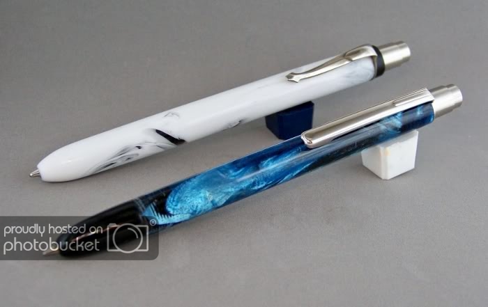

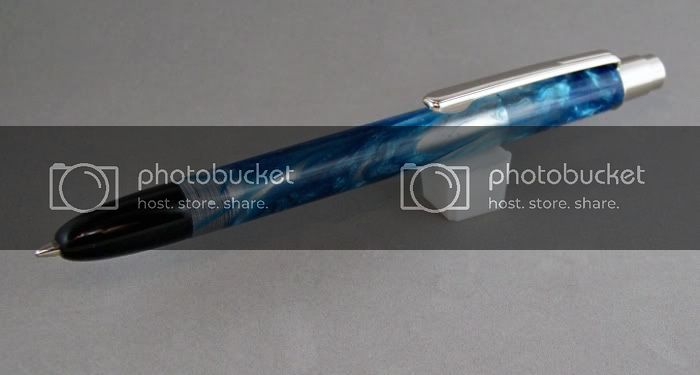

I did a kitless click a while back that started out clear and I ended up painting it black. You can see where the paint wears on the threads so I'd definitely be aware of that. I think I've got a pic...
Unpainted:
Then painted:
You can see the painted threads in this pic pretty good. Even with a black section to try and mask it even more it still stands out.
