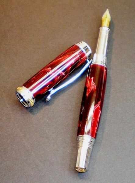

Here is one of my ruby red swirls. The tube was painted with Testors red that matches the bakelite pretty much.

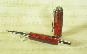

Here is one I powdercoated the tube black.
