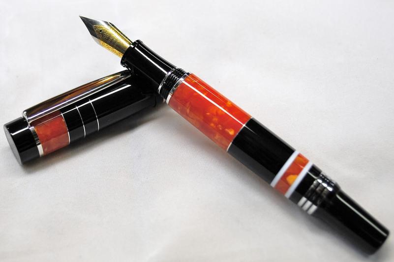

I've been looking at the special edition Delta Momo in the catalogs and finally had to give in. Call it a guilty pleasure, and my apologies to the traditionalists.

I like the look. Great job on the pen.
The big question on my mind is where you got the kit. I generally look at blanks and not items like this. I should change my ways since I'm missing the boat here.

Thanks, Jim. The parts are from Churchill (center band and bottom finial) and El Grande (section, clip and upper finial).
Segmenting blanks can be very frustrating. This one wasn't bad--just had to do the blanks over once. I used to make a lot of segmented pens and have acquired a Woodchuck tool since then.
My opinion is that the Woodchuck takes a lot of the risk out of segmented turning. Once you're used to it, it's smoother turning than with any other tool I can think of. I had trouble finding specific instructions for using the Woodchuck and had lots of trouble at first. Then I was advised to turn up the speed and use the tool at an angle. All downhill from there.
I came up with the same approach on the woodchuck. Looks like some instructions would help! If I have a difficult blank or segments, I hold a 30-40 degree angle. I am turning everything fast now, it is working much better. :smile: I do seem to be wearing the carbide faster than I expected...

Just blown away. If I had to pick one thing, I would like to see the long piece of black in the cap broken up. Maybe w/ some of the white bands you have on the body. Just me though. You surely have a talent here. Great job.

Jim, thanks for the positive feedback. I saw the Delta Momo and my first reaction was kind of shock. Then I kind of liked it. It still seems outrageously overdone, but I like the color combo. I'm thinking of how I can do a cap with the transparent part that shows the nib inside.
Beautiful Robert. Would have been really cool if the major black sections were carbon fiber. I think I like yours more than the real Momo.
Thanks, Chris. I agree that it would have been cool to use the carbon fiber and I gave it some thought. Of course it would have meant segmenting blanks in a tube size that CF comes in, and I wanted to use the Cambridge/Churchill/El Grande parts. To my knowledge no one's making CF blanks in 31 and 33/64".
Thanks, Chris! Yes, as I said above, I wish I could figure out how to make a cap with a clear section that shows the nib inside like the real Momo. I've come regret the white bands on the barrel, actually. I think I should have used aluminum instead.
