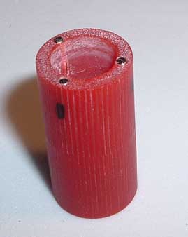

What it is is a very thin rim of plastic. As you can see, the 1/16" magnets are about the same size as the thickness of the walls.
One hole is spot on but the other wandered a bit. I an reviewing the design and may be able to thicken the walls a little.

Attached is a pic of where I drilled 1mm diameter holes on a flat PR workpiece and filled with alluminium pins. You'd just swap around the drill and piece to drill around a ring.

I would make a drill jig for that. Something that would fit snugly in the id with a shoulder to sit on the part. The two holes located in that you just drill your part thru the holes. If something like that would work for you, let me know the part id, od, and the drill size for the holes and I'd be glad to make something and send you to try out!
Thanks Paul. I'll keep that in mind. I stated to work on something with a guide but decided not to spend too much time just yet.
I was able to change the design so that the OD was bigger and allowed a thicker ring. I was able to do this by hand with a pin vise. This will suffice to see of the whole thing works out. Then I'll worry about doing multiple ones faster and more efficiently.

Wow Skiprat that is some really precision drilling. I am in the other camp when it comes to drilling for precision. I have never had a good eye for that at all.
