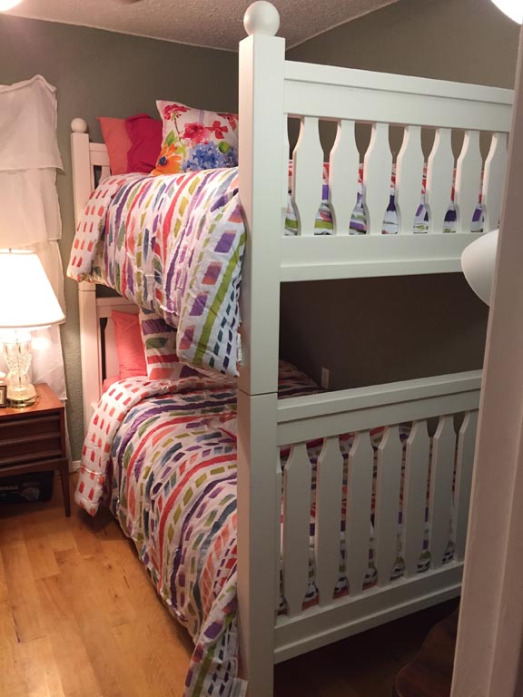

I used the HF oscillating sander in building a set of bunk beds this past summer for my daughter. I had lots of slat sanding, 36 to be exact and on both ends, and both sides, which meant 144 that were run across the oscillating spindle sander:
http://www.penturners.org/forum/attachment.php?attachmentid=157256&stc=1&d=1481666282
To be honest, If I had it to do over again, I would go with the Ridgid belt/spindle oscillating sander. The versatility of the belt AND spindle really is helpful. Grizzly has recently come out with a belt & spindle sander.
