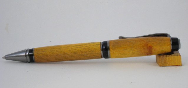

A friend gave me a blank today . I decided to put it on a Black titanium Cigar kit from Ernie at Beartooth Woods . It has a couple of small knots on the upper barrel . It appears to have some dust in the grain , although I did use DNA between each grit . The dust is really fine powder . MM to 12000 , CA/BLO 3 times , MM to 12000 again & Renwax . Any comments or suggestions welcomed ! He has one more blank , and I think there's alot of room for improvement . Thanks for looking !! [8D]
Chuck the pen looks pretty good, Bois D`arch (Osage Orange) is a beautiful wood, but you may have noticed it's harder than an ex wifes heart!! usually the grain is pretty tight so there isn't much place for dust to hide, but compressed air will get it out.

Thanks for reminding me Rick ! I read this discussion about a month ago . Got two can of Endust Duster . I will try that next time .

Nice job, Chuck. Try using compressed air instead of DNA. Alot less hassle and better results,IMO.
That's funny about the ex-wifes heart ! ROTF I've got three of 'em ! Yes it was hard and when I hit those knots it was all over with . Let me know if your six month wait was worth it . OO apparently , is hard to find here in Indiana too . My friend gave me this blank cut to .5" x .5" X 5.25 He says he may have enough for one more . I'll ask him where we can get more . This blank was very bright yellow . He says it turns green . Either before or after sunlight . I don't remember which . Do you know about this ? Is he right ? Thanks for the comments everyone ! [8D]

Osage orange is a very recongizable wood. Those who know it will stop in their tracks when they see an OO pen. My last OO cigar pen went to a forrester who said "Hey! That's osage orange" while browsing my inventory.

Thanks guys ! When I got this blank , it looked this color :) but got darker with the CA application . Any recommendations ? I'd like to see the next one more the original color , but would still like the glossy finish . Thanks to all for looking !! [8D]
I've never seen OO that was that open grained. Are you sure that's not yellowheart or movinguie?

Thanks Redfish ! I'm going by what my friend called it . ( should have put that in the OP ) I didn't question him " cause I don't know the difference . Can we still call it OO ?? [:o)]
