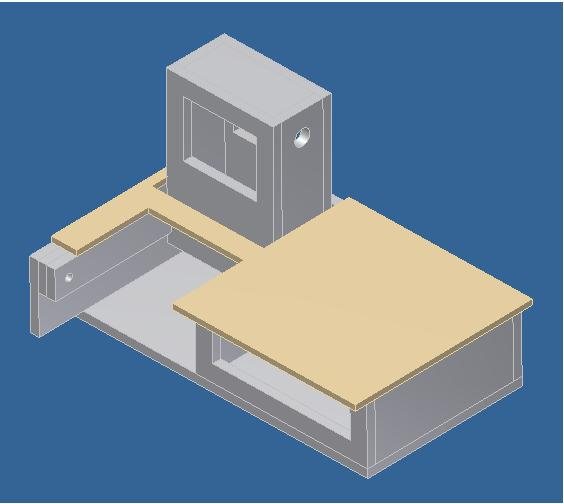

Working on building an ornamental lathe to enhance my turnings (especially pens ;)) Felt like doing a build thread on the project, especially so others can use my ideas to make their own. The base unit of the lathe is built almost word to word to these planshttp://www.woodturner.org/products/aw/, but then it's also going to have options for 120 point indexing, and ornamental milling. First step is to model the original lathe in Inventor 2008 and after that modifications will be made. Instead of the called for 3/4" mdf for the table of the lathe, 1/2" corian has been substituted

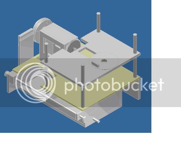

Parts have been outsourced, the over head router part is being built totally different but i'm a little too lazy too go back and model it, besides i work better making the solutions on the go. One of the changes that i made not evident in the screen shots is the fact that i have added a MT2 to the spindle with a knockout hole, hopefully my uncle gets the parts back soon, the only thing he's charging me for is to order in the 1.5" steel for the spindle, so $20 total in parts:D!

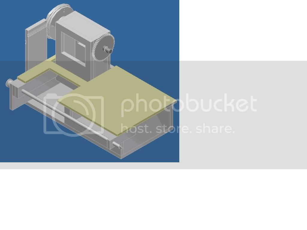

Ok an update. This is a little bit of a teaser. Have the bed extended, the ways mounted, the milling table on there and the plate that the router is mounted to. Stay tuned for further updates!
We await your developments with great interest.:):)[:X]
