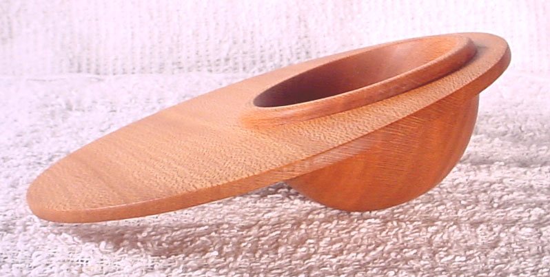

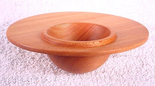

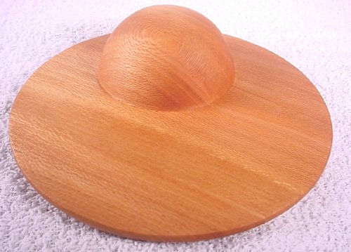

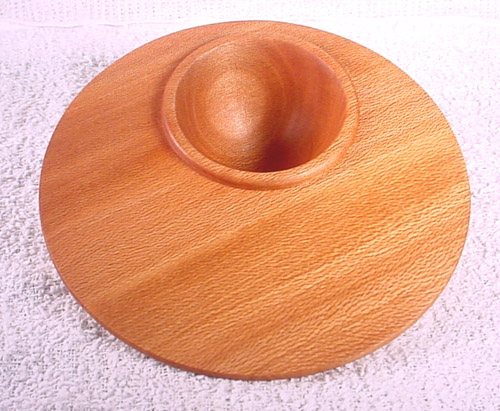

After seeing Stuart Batty do an off center square bowl I got a little inspired. I wanted to change it up a little though, and this is what I came up with. I am calling it Orbit, although I probably shouldn't be naming my stuff yet. It is sycamore and about 6" diameter. Just oiled so far.
As always, any critiques are welcome.
Thanks all.
Yeah Randy it is off balance all the time. Anything over 500rpm and the DVR was rockin a bit. Honestly, I was quite surpised that it did rock so much on this small of a piece. I have heard some people will counter weight when they turn off center but I just went with it.
Joe, the mrs. and I are planning an east coast vacation this summer, so you never know. [;)] I'm hardly qualified to show anyone else how to do this.
A couple of quick observations:
I can't for the life of me figure out why you would be reluctant to name that one, it is one spectacular piece of work!
Secondly, I've done a few of those and you will find it MUCH more pleasurable to turn if you counterbalance it while you turn. I use scraps of dense wood a couple of inches square and I screw them to my plate.
Finally,.... Kevin, Don't underestimate the skill that was required required to make that piece. What you accomplished there is truly something to be proud of.
Both innovative and expertly turned. Real lathe art.

That's one of the nicest bowl designs I have ever seen. Either I haven't been looking at many or that is really unique - I think the latter.

That is really nice, the form is appealling but the attention to sanding is what really sets it off. A lot of times people forget how important getting rid of sanding marks is. The shape of the cupped area is quite well done.
Drew
Kevin, Great job, make sure you bring it to the next meeting (March 10th). I've done 3 or 4 since seeing Stuart's demo using some small mesquite half logs I've had sitting in my garage for well over a year, I hadn't considered turning them round before moving the bowl off center, I may have to steal that idea for myself.
How thick (or thin) is the wing? It's hard to tell from the photos.
Jason
Yes, Stuart was quite inspirational, wasn't he. Although, I don't think I used a whole lot of what he showed though.
The wing is between 1/8" and 3/16", it measures average of .175"
