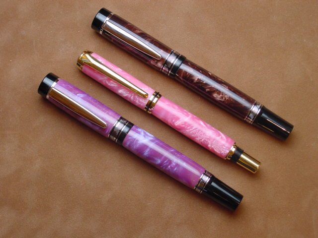

Here are some new resins I cut, would greatly appreciate your commments on them. Good, bad & indiferent...........[:p] Thanks, Anthony
Purple Passion Pearl, Pretty Pink Pearl, Black Bronze
Anthony, the Black Bronze would be my favorite. Now, really, Anthony, do you think I would carry a pink or purple pen in my pocket? (No bias here, just a matter of identity!) Actually, it looks richer, more elegant, and probably higher priced.
It is a matter of what the buyer likes. They are all very nice.

The only thing I can say is WOW !!!
The Black Bronze makes a great "Mans" pen and I think most of the "Ladies" would go GAGA over the Pretty Pink and the Purple Passion especially in the smaller pen in the middle (I don't know what pen kit that is), they have to be 2 of the most beautiful colors that I've seen .
Thanks, so far so good, the girly looking colors are for just that. about 40% of my clientel are women, so I do not discriminate about the selection I offer them.

<b>AHHH COME ON FRED</b>... I think that pink pen would look just stunning with a good old flannel shirt... LOL.. not even to mention how it would set off your eyes after a night of good old Kentucky Bourbon... LOL.. BTW Fred did you get my email that I sent through the group to you
Anthony, those pens are real neat... where did you get the acrylics.. a lot of my customers are women also and those would be great colors... do they also have a real nice red in that effect... I am getting orders from the Red Hat group.. so I also need a good red and a good purple (something darker than the one shown).. The black bronze looks like a really rich color combo..
I have been thinking that I need something that would appeal more to women. I think you have found it! Very nice job, Anthony. I was talking with my wife yesterday about coming up with a new name for the Junior Gentleman pens. People just don't tend to buy something with a name like that for a woman. Any suggestions?
Yup, Fred said it!! Pretty distinct---I like the top darker one myself---but, sure do see the others as "great" pens for the ladies!!!! Nice work Anthony as always!!!

Anthony, all three look great, and I agree with the others that there should be a good market for the pink and purple with the Lady's. That top one is my favorite, but there all beautiful, nice work!

I did a Satin Ni European at Thanksgiving with the Purple Passion. It was what my wife picked out for her pen. So I would say that it appeals to women. I love the way that it finishes. It's almost as though you can't ever see the bottom.
Fantastic craftsmanship Anthony, the pens look great. Betting the ladies will love them.

I think you done a great job Anthony. I bet the pink one is the first to sell. Margie (wife) picked it out as the best of the bunch--and she aint ever wrong.
Anthony are those blanks some of the Inlace Pen Blanks from Craft Supply? They look really good no matter where you got them.

The polyester resin blanks are from the Cave Creek Casting Co. I cast them this week in my shop. [:p]
After throwing away about 10 rattle snake skin blanks I was trying to cast in clear resin, I turned my attention to something a little easier and mixed my own resin blanks. I was reaaly happy with the way they came out, I put in another order for more colors & dyes.

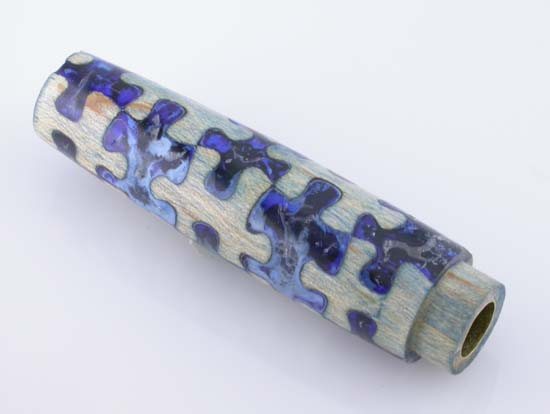

I appreciate you sending instructions. Hmm... I wonder what the possibilities are of having a pen made out of aluminum or titanium or even corian and doing inlays in it with a contrasting color with the pourable resin? I imagine it would be easy to sand back to flush on a tougher base material. It probably runs like syrup though, so might be limited to one side of the pen only.

Another thought of what's possible with casting your own; you could turn a pen from wood, leaving it about .015" oversize. Carve out a cool pattern with a laser, drills, Dremel, or by hand into the wood. Cast the acrylic around the whole pen and turn it to size. If it works correctly, only the carved out areas will have acrylic left in them. It should produce some dramatic results.

Anthony, I just did an experiment with the process I described above. Since I don't yet have the good resin, I tried with CA and some dye. Even though the experiment was crude, I was pleased with the results. This means that the concept should work well with the good resins. I didn't make this part oversized to begin with, I just used a piece I had worked on earlier and returned it to the same diameter, so the discoloration in the wood should go away when I turn it .015" smaller than the original.

Bruce, great idea, my problem has been putting my finished barrel or blank and casting it in the resin. None of my molds seem to work out right. I would think on Jim's inlay pens, you could spread the resin in on one side and do the other side the next day.
Definately having that laser engraver, you could come up with some real wild ideas and patterns.
