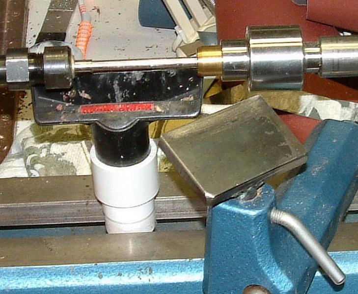

I would like to challenge with another reason buy the live centre with a removable parallel tip and replace it with a brass bush nesting the mandrel 3/8 of an inch no more colleywobbles. I devised this system over ten years ago it works.
Have fun.
Kind regards Peter.
That's a good argument against me too Peter. Although the factory tips are not so great, the straight shanks make it easier for you to modify or make your own replacements and to a better tolerance that isn't sloppy in the hole.
