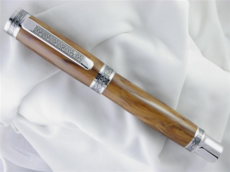

William the following is my second mistake today. The above should have read 1/16". The second was using Emperor bushings to make a Gentleman's kit. Being as the lower end of the gent bottom barrel is tapered I couldn't use the Gent parts unless I wanted to remount the barrel on the lathe and recut. I didn't want to take the chance of screwing up such a nice blank and I remembered your delema so I pulled out a Emperor kit and gave it a try. As you can see it work perfectly. So my mistake is the answer to your question, hows that for service. So grab some gent tubes and go to work.

If we mount blanks and turn them as gents pens (with the slope) and then see that the blank is stunning and would make a great Emporer, couldn't we remount the emporer bushing on the nib end and turn off a little material and have our Emporer?
This way if it is only an "OK" pen, it stays a Gentlemen (cost under $15ish), but the killer blanks can become Emporers AFTER we see what was "near the tube".
What do you think?[;)][;)]
wayneis
Mar 15, 2004
1,948
Okemos, Michigan, USA.
Sorry Ed, good idea but it won't quite work. The gent is tapered and the Emperor is not. The problem comes it that the tapered end is smaller than the Emperor. The thing that may work though it to turn it to close to the Emperor size, do a little sanding and depending on your choise of finish wipe a light coat of BLO or something just to get an idea what it will look like. Then if you deside it is not worthy of the Emperor finish cutting the taper for the Gent, if its good enough for the E. then finish sanding and finish.
