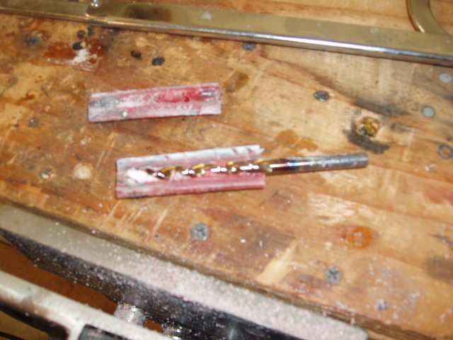

I finally was able to get into the shop and start working on a couple pens......:D

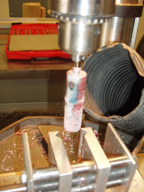

I was drilling some Acrylic blanks from Ernie at Beartooth Woods, when I guess I had a lapse in concentration. [:I] (No injury to me!!):)
I was having issues with shavings getting stuck to the drill bit just below the chuck, so I was using a piece of scrap wood to knock them off... Anyway, I guess I left the bit in the blank too long and I got the blank STUCK ON THE BIT!!!!! [:0][:0]
Oh CRAP!! Now what???

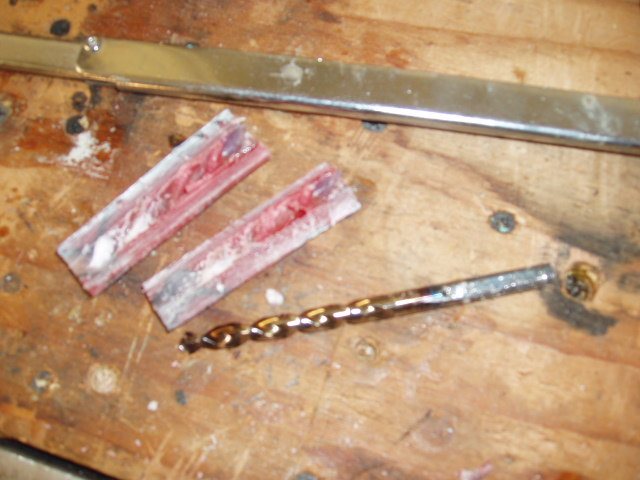

I took the bit out of the drill press and the blank was STUCK!!!!!!!!!
I tried heating the bit with a torch to see if that would release the blank. NO GO!!!
So I had to cut it with a hack saw...
Its FREE!!!!!
1 half blank is toast.... The other half will make a Sierra, instead of the Euro it was supposed to be.... Half a save....[^]

It looks, and from your description sounds like you were using a dull bit that overheated, partly melting the plastic which then solidified. If you're having trouble with shavings sticking to the bit, it's a almost certainly due to overheating.
Gerry,
I'll bet you are right on target!! I have <s>ab</s>used this bit and it is a Bradpoint bit.... Seeing as I heated it up red to try to get it unstuck, I will probably toss it, as it's integrity has most likely been compromised.
Frank,
What speed would you recommend? I have never had a problem before, but if I am drilling TOO fast, educate me....[;)]
Bob in Sachse
I drill acrylics at about 1100 rpm and have no problems at all. I don't and won't use bradpoints because you can't re-sharpen them with a DD and what few I've used gave me nothing but trouble. Once was even dull when I got it, I mean really dull.

Glad to see that someone else has done my screw up... I had a bit get stuck same way.. too hot and melted into the plastic... only instead of using a hacksaw, I thought why not just put the bit in my hand drill and reverse the bit - should work right [:(!].. I clamped the bit in the hand drill, clamped the blank in a vise and promptly twisted the chuck off the drill... [:(][xx(] didn't budge the bit.... wound up losing both.[V]
But I learned to keep the blank cool... I now add a little water as others have suggested. [:p][:)]
