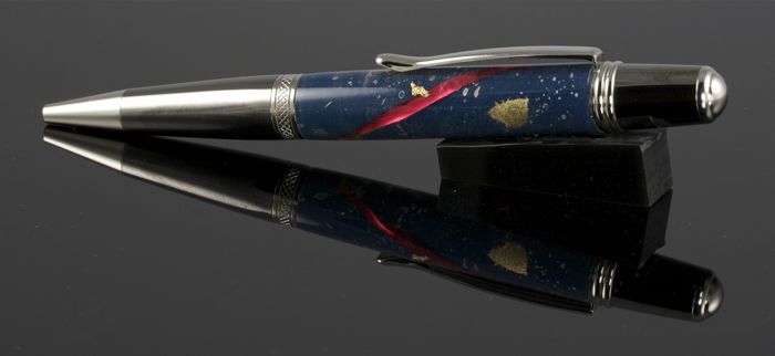

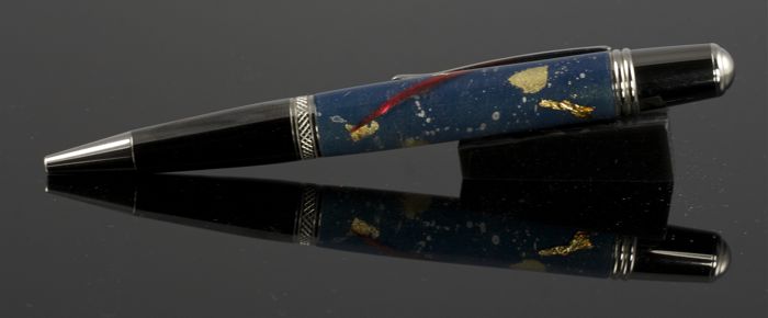

This pen is made using CA only.
attachment.php
attachment.php
It started by painting the tube blue then splattering with silver paint. 4 coats of thick CA later I added some gold leaf (smudged); then I added 4 coats of thick CA; that was followed by a piece of red ribbon followed by 6 coats of thick CA (I had to add extra CA because the ribbon curled); then some more gold leaf; then lots of coats of thick CA until it reached final thickness.
I would apply one coat of thick CA, let it start setting for 30 seconds to a minute then use aerosol CA accelerator then the next coat of thick CA. That second coat is now hardening from the bottom up; add a little spritz of accelerator then another coat of CA. Repeat until you have applied the last coat of CA.
