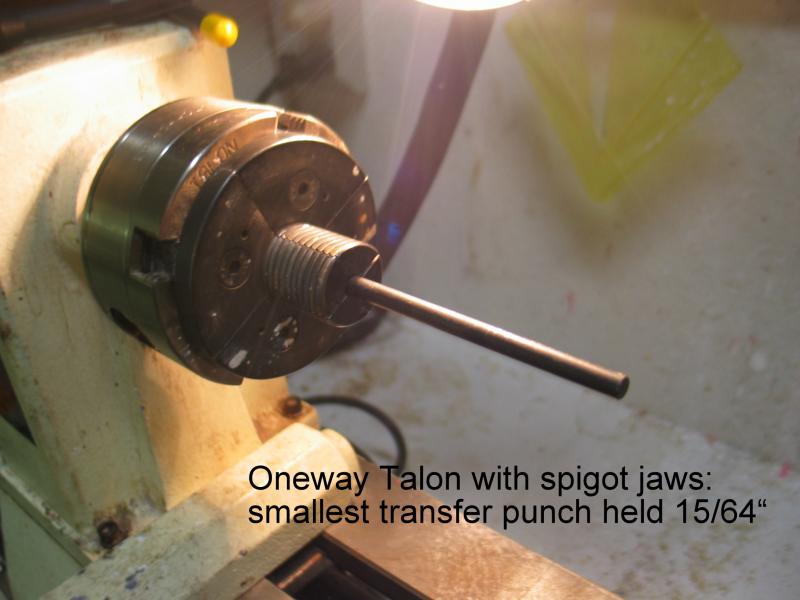

The spigot jaws on my Talon chuck are a bit "grungy" but a 15/64" transfer punch is the smallest diameter punch from the HF set they hold snugly.
Not intending to start an argument, my jaws absolutely clean will hold a 7/32" transfer punch snuggly wuggly!:smile:
