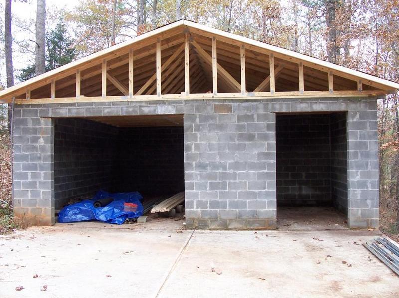

Well, I started this venture over 8 years ago, and am starting to finally get to the point, I can see the end. I had a 150 foot double driveway with turnout poured down to the shop (shell) last year, and just this past month, had custom trusses delivered and installed. I can start to visualize tools and stuff actually in the shop now(still dreaming). I have a ways to go, but I thought I would pass on the excitement to those who, like me have tried to do this over a number of years and feel like the completion day will never get here. WOOHOOO!!!!
The shop is 25 feet by 25 feet on the inside dimensions with a ceiling that is 9 and a half feet high. The main work room on the left side is 17 feet by 25 feet. I have a finishing room in the back right of the shop that is 8 feet by 12 and a half feet, and the room you see on the right front is also 8 feet by 12 and a half feet for the lawn mower, and other type yard stuff. WOOHOOO!!

Congratulations on your progress. I have serious shop envy right now. Have you decided how you're going to heat/cool it yet?

I will probably have the guys that do the AC/Heat for the house come by and let me know how much a unit will cost to heat and cool it. I have gotten permission from the "power company" and the county, to increase my home power box to 400amps. We will split the power to the normal 200amps the house has now, and send the rest of the 200amps down the hill to the shop! I have been sealing the walls with Dryloc to keep the moisture out in the inside. I will stud the walls, and then run all the electric stuff, then insulate the place, and then finally drywall the place. I am going to run phone line, Cat 5e, and satellite feed down to the place, so it should be a right proper hang out. I would love to host a get together, but I still am a ways off from being ready. Once I move tools in though, everyone is welcome to come on down! There even might be a fridge stocked with cool spring mountain water.....

Good start. Commode/sink? Next--4 skylights in the roof. Might consider rolled insulation under the roof between truses. Also 1 1/2" stryfome sheets for wall insulation. OSB makes a nicer shop interior than sheetrock for nailing/hanging purposes. Double outlet boxes every 6 ft all around. 250 Hal. light hung at gable with remote switch at house to see at night. Plenty of circuits for power. Just before move in time, Home Depot has a good sealer for concrete. Lay down a good coat all over. Try one gallon first. Shouldn't take more than two gal. Plenty of florescent lighting switched for a few or all lights at a time. I wish I'd have used a couple of 'roof windows' instead of all skylights, to open for air circulation. A pellet burning stove makes a good shop heater. Get ready to enjoy yourself.
There is absolutely no plumbing in the shop! The reason is the county will then decide that my "shop" is living space, and then the codes all change to having to build it like a $#@%^& house. The only pipe in the place is going to be for dust removal, and for compressed air.
I have a 2 part epoxy floor to go down before I build the walls on the inside. I have a plan that has 18 4 panel flourescent lights in the main room, 3 4 panels in the finish room, and 2 4 panels in the lawn mower room. I plan on having a guy come out and sink a phone pole for lighting over the concrete, and we have several other lights for the front of the building. No sky lights, they let the alien radio signals in that control your brain and make you actually do work....Metal roof will help keep the rays bouncing back to the mother ships. I plan on building a cuppola on the roof with a big ole' weathervane on the top!
OSB BOARD...GEEZ....I have a really nice floral pattern wall paper picked out for the main shop room...just kidding....I have a faux denim paint treatment from Ralph Lauren going down on the walls....LOL.....
What pitch are the trusses? They are similar to mine. I can stand up between trusses. We put in a set of folding stairs and laid 3/4 OSB for flooring. It makes for a large amount of storage space.
