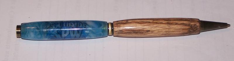

One from this weekend

A guy at work runs the Southside Pro Wrestling franchsice in Virginia Beach and wanted some pens for his clients. This is a proto type. He wanted wood as one of the barrels. It is oak with some stain applied. The SPW is a clear address label. I took the center band off after I took the pictures. I wanted to see how it looked first.

I see what you did with the oversized pieces, but the nib should really match to get the 'flow' of a finished item.
I really like the upper barrel!
Scott
I like it too, but I think it would look better on a slightly larger kit. Being that this looks to be primarily for men, maybe a cigar kit would work better, and give you the larger barrel diameter.
