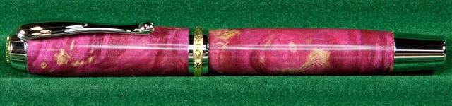

Statesman Jr. made from Dyed red maple burl. The finish is two coats of Formby's gloss tung oil and then buffed with the Beal system, then a top coat of TSW and buffed again. First time I finished a pen this way, it took longer but it looks and feels pretty good. Any suggestion on the steps used? Thanks for looking!
Very sharp. I like the hints of yellow in there. It is funny you metion tongue oil; I have some that we used on our kitchen cabinets last weekend, and thought it might look good on a pen! I have yet to try it, but this certainly gives me more motivation!
Another fine looking pen RT. Great color on the blank.
I think you will find this a more lasting finish, than the friction polish.
I've used Waterlox from CS allot, a couple 2-4 coats really brings out the
grain on some woods and buffs to a nice soft sheen.
R.T., I am glad to see your post. I have used Fornbys tung oil finish for years on lots of flat work and lots of turned bowls and platters. I often thought of using it on pens but never tried it. If I remember correctly, fornbys tung oil finish is not pure tung oil. I have applied it to bowls with the lathe on, several coats then steel wool then paste wax. I wonder if friction polish, without the wax, on a pen would give that high gloss?
Formby's tung actually has varnish in it. Glad to see it as I too have used it on flat wood and have a Kitchen table that I finished with it and is the most durable finishes I have used. Just haven't put it on a pen YET.

Thanks everyone, appreciate all the nice comments!
And for those that thought I spelled "Tung oil" wrong, that is the way Formby's spells it. Might be because it's not a true tongue oil so they spell it different. Don't really know why. [:)]
Jimr, I use friction polish a lot and it gives a nice shine. Some guys say it doesn't hold up, I'm still waiting to see if the stuff I've been using fails and so far its done very well. But its only been a few months (6), so we shall see and then I'll have to come back and say they were right. [:)]

Very nice job on pen RT. Color is outstanding. Pretty grain. Finish is outstanding. Sanding and finish make the product. That is what I tell my students.
