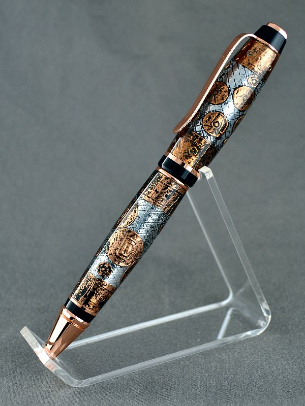

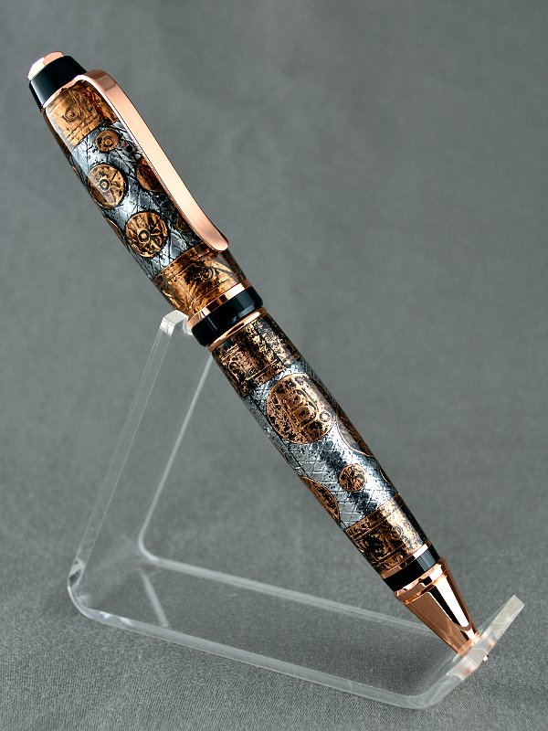

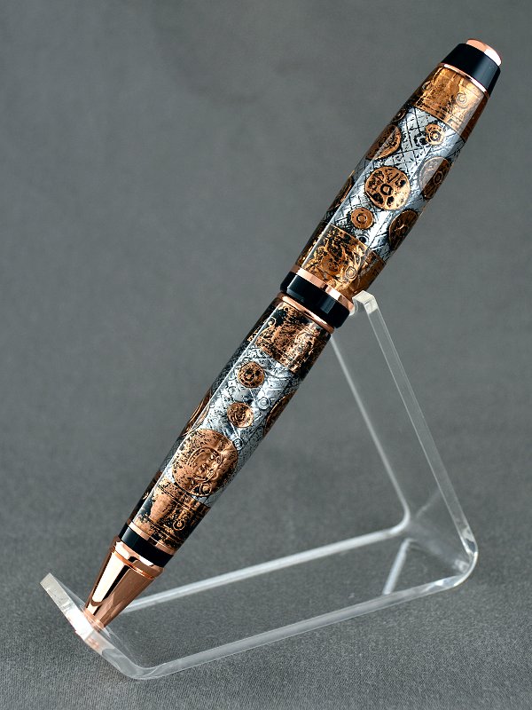

I haven't made a pen just for me in a long time, so I made this one that can be stolen only by somebody with the same initials.
I used hollow punches to cut the copper tape discs, and a large nail set to stamp the "rivets". The diamond pattern on the aluminum tape was created by rolling a 1/2" diameter threaded bolt on the diagonal.
I used letter stamping tools for leather to emboss the letters on the discs applied to the lower barrel, and used Silmar 41 resin in the casting.
I like the contrast between the aluminum and copper, and how the copper tape blends into the copper components. It's shiny, too! :cool:
CC&Q are welcome, and thank you for looking.
