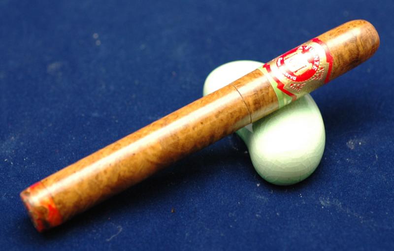

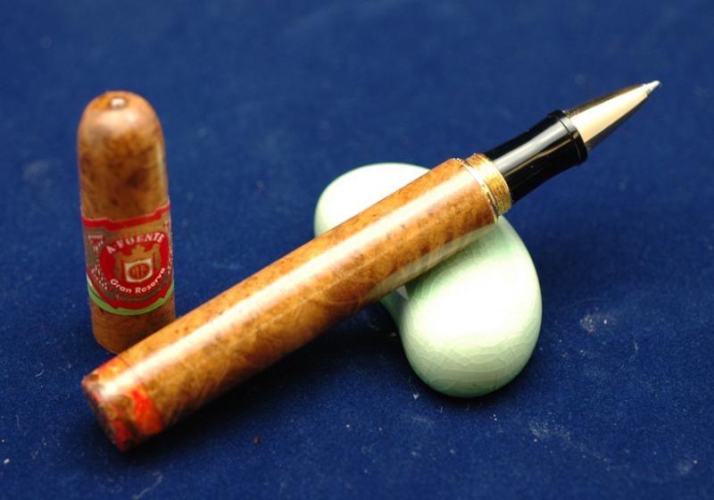

Hi All,
My wife is always telling me my pens look like Cigars, I guess this time she is right.
Roller Ball Pen Specs.
.600 Round
Capped 5" 1/8
Uncapped 4" 5/8
Weight 25 Grams
Made from Teak Burl, the End of a Pine Cone Blank and a Cigar Band.
Finnish is 4 Coats of CA and not polished.
All comments are welcome

Thanks All, for the kind words and Martin the pen you made is GREAT, on the Finnish I used 2 coats placed on top of the wood with a paper towel and then placed the Cigar Band on top, put Mod Podge on top of the band and then more coats of CA. if you use the Mod Podge it will not let the CA eat the paper.
Thanks for the tip. Right now I still like the non-glossy look of finishing with tung oil. But when I finish with the next couple I will try a high gloss version with the label under the ca glue. Adding the clip on the cap end is presenting me with a lot of challenges.
