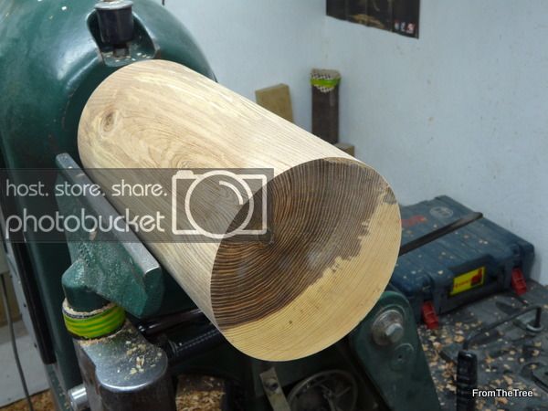

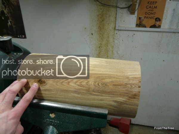

the initial blank was 13" long and about 7 1/2" square- mounted between centres

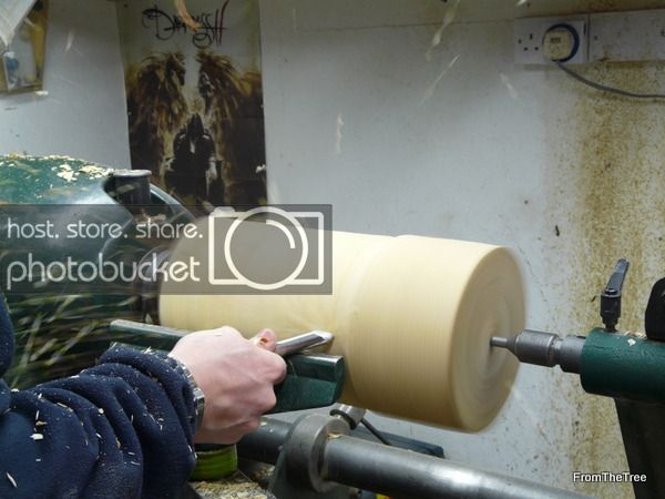

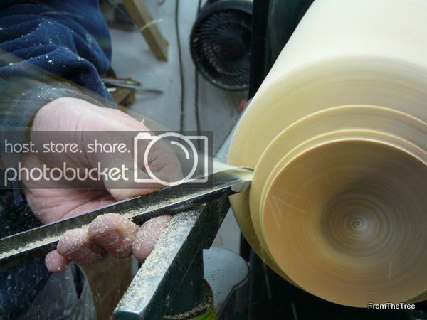

roughing out with a 5/8" gouge

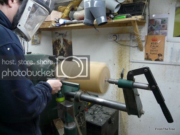

i've removed it from between centres now and have it held on a 6" faceplate

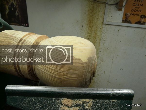

oh dear- I was going to make a much taller piece but I might have to change my plans to avoid this!!
I start to the rough shape
here's a pic of the top 2/3rds shaped and its now ready to hollow out

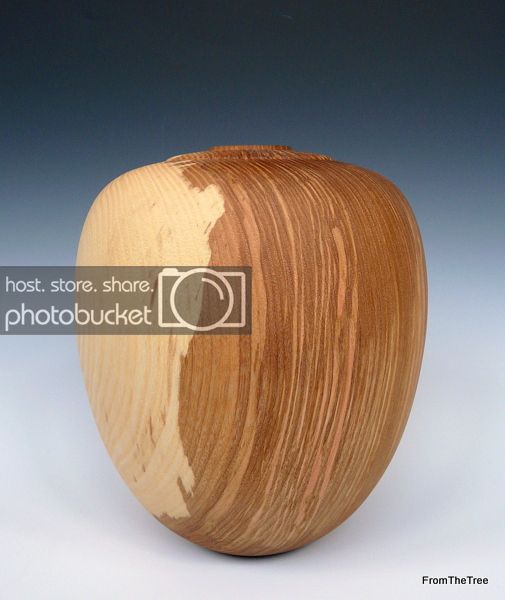

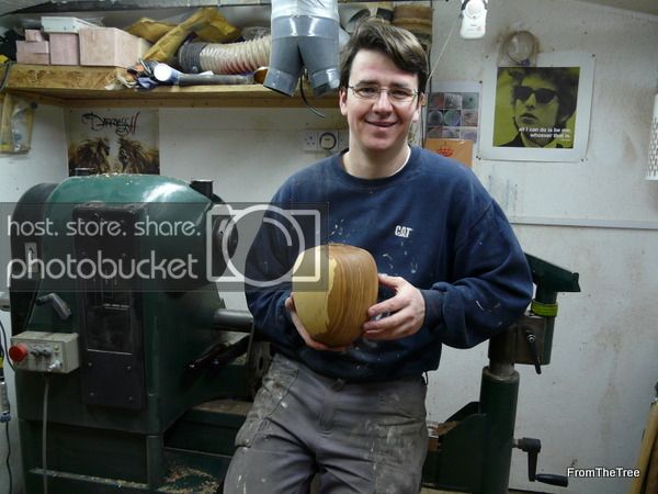

8" tall by 6 1/2" wide

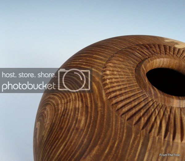

carved neck detail
Great piece George, at least we know that this one is not a photographic trick with a miniature piece...!
You called it Olive Ash, can you expand a little...???
I never saw you big lathe before, and I can see that the old girl is built tough and should have plenty of "grunt" in that motor, what size precisely..???

That's quite a lathe you have!

Olive ash can occur in the heartwood of common ash tree's (fraxinus excelsior) it mainly happens in big old tree's but can occur in younger tree's too. I think it got its name as the figuring looks a bit like the Mediterranean olive plus our native ash is a member of the olive family- the best example I've ever seen is in the late Tony Boase book "bowl turning techniques masterclass"
my lathe is a vb36 I've had it for 11years now and it has a 2hp motor, they are now fitted with a 3hp as standard but I've never managed to stop or slow mine down!!
What a beauty! Like the shape and the wood grain especially the little carvings which added some charm to it. Great turning!

George,
I love the picture where you caption "oh dear...." and in the backround there is a poster that says rightly "Keep calm and don't panic". How true. Great piece of timber, and nicely executed form. Thanks for posting this.
