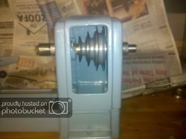

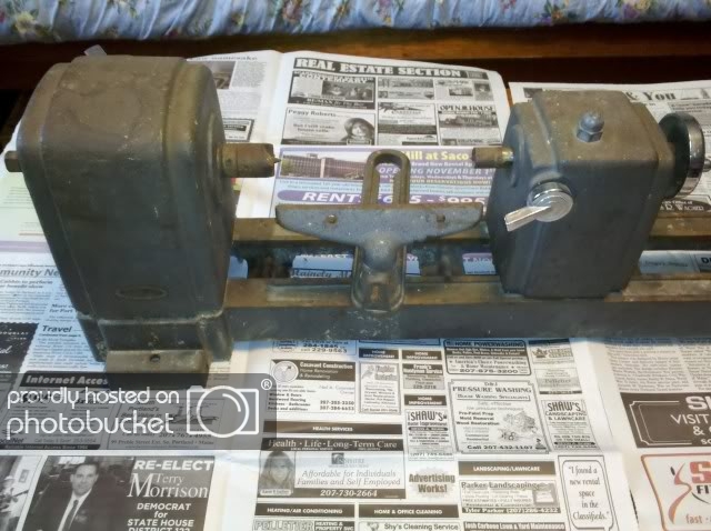

A great little lathe.... here is mine.
Before restoration
And After
Enjoy

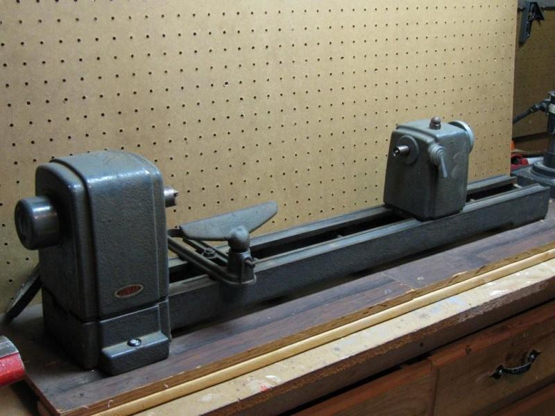

Yep...Thanks again all but especially Wildman and Dave...that's it and I guess I will take it along for the shop. Limited space in the garage/shop but WTH, I'll make room and tinker with it !!!
Best wishes,
Joe in PA
