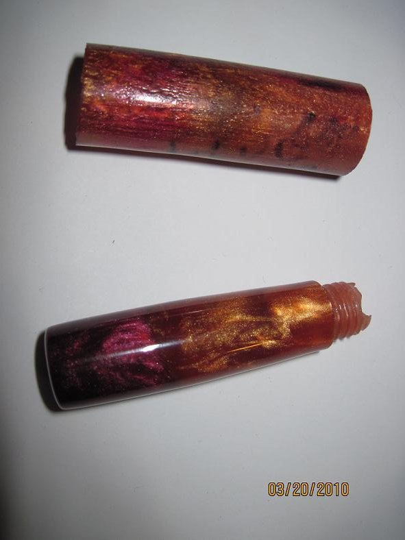

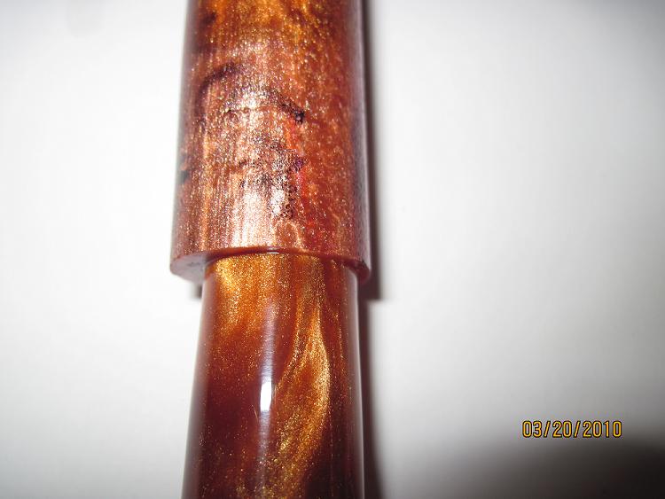

And even though the lid is unfinished, and the threads are broken, and the center is not big enough for a cartridge to fit into, and it isnt long enough for any other refill medium, IT IS MY FAVORITE PEN I HAVE EVER MADE!:biggrin: so far..

Ron, I'm right there with you. Looks an awful lot like my several attempts at making a kitless pen. Still working on it, my crayon pen excluded. Keep up the, um....uh....good work.:rolleyes::biggrin:
PS. You're a braver man than I for displaying your failures.
Ron, that looks like caca. Unfortunately for me, it looks less like caca than my first attempt at kitless. Keep trying,and trying and trying. You will get there. Do you ever sleep?

Thank Ya Sir! I am tryin! I have another attempt going right now, but i think i have realized that i need to invest in a die holder before I am going to get much further than i am right now. I got really lucky on the threads on this one, and have not been able to reproduce. That's ok... I wanted to tick the wife off with the news of more tools!
You have a drill chuck right? You can get die holders to fit the MT on your lathe, but you can also get cheaper ones that simply chuck in your drill. I vote for the cheaper one, because there's a few different sizes of Die's and you basically need a different holder for each size, so might as well not spend the extra money on a MT version in my opinion. Another option of course is to just forget about the die and buy a few bolts instead. If you have a drill chuck and a collet chuck, well bolts already have threads on them, you can chuck a bolt in a collet chuck on a wood lathe and cut the bolt into sections however long you want them. You can then drill out the bolt with your drill chuck. You tap the pen section to match the bolt. You could turn the entire bolt into a nib section using a file, or you can just use part of the bolt for the thread part and make a plastic nib glued into the inside of the bolt. All do-able on a wood lathe.
Are you saying that you use the bolt as the nib holder and screw and glue it into the pen body? Do the threads then extend to hold the cap also? I think that I get this idea. Being a visual learner do you have a picture of this and if so would you post it?
I don't have a pic, you'd be better off searching through a bunch of Skips old threads. What I'm saying is that a bolt is already threaded. A nib on a pen like a jr gent has threads on it for a cap. So the bolt threads would be the threads for the cap to screw on to the pen. The body of the pen can be tapped so that the threads of the bolt not only will allow the cap to screw on, but you can screw the bolt into the pen as well..so half the threads are in the pen body and the other half stick out to be used for the cap to attach too. So, lets say the go 1/2" into the pen, then they stick out the end of the pen 2". You leave a few threads close to the pen body and the rest of the threads you file down to become a rollerball nib. I do believe all or most of Steves pens used to be made similar to this, using the existing bolt threads. Now maybe you don't have a tap for that bolt so that you can tap your cap or tap your pen section? You can take anothe bolt the same as the first one and make it into a tap with a grinder. Simply secure the bolt and grind 4 channels across the threads. Chuck the bolt and file the end down so it tapers and now you have a tap. Another alternative to a bolt, is plumbing fittings. Those are brass, which is real easy to turn with a chisel. I have been using some plumbing fittings on the ends of my pens to cap them, so you unscrew the fitting and change out the refill.
