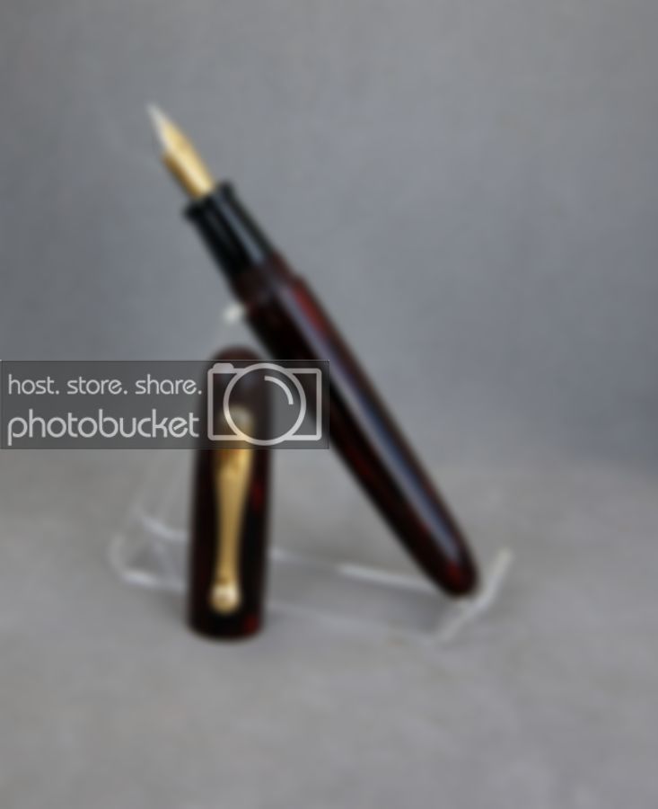

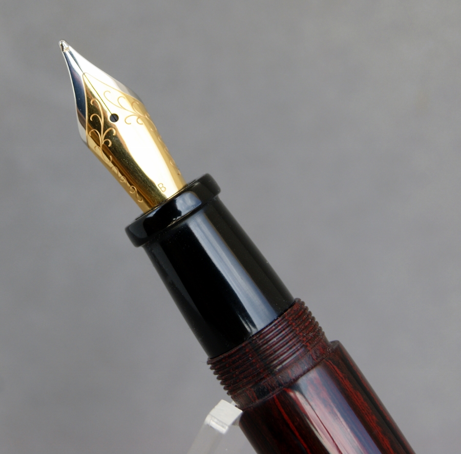

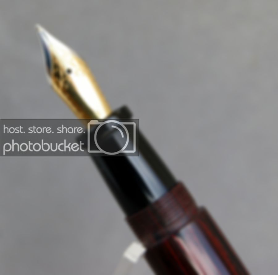

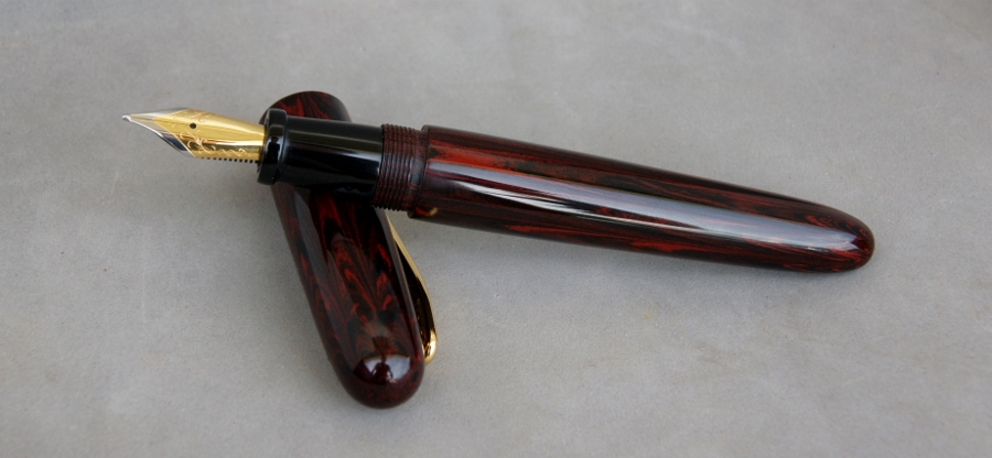

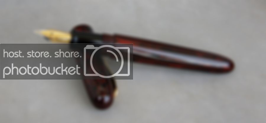

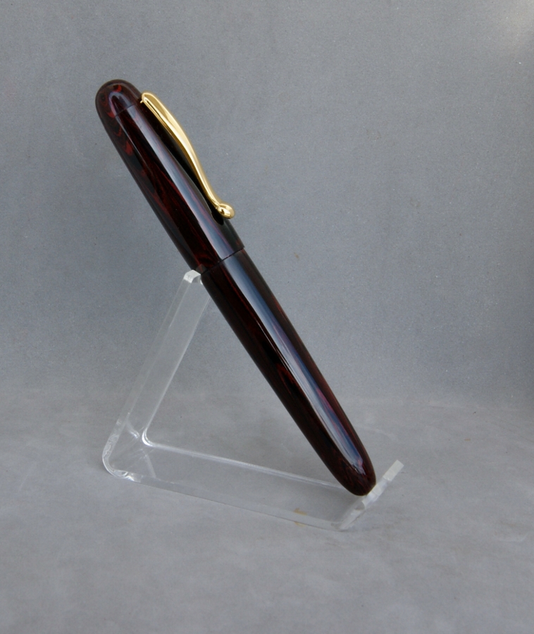

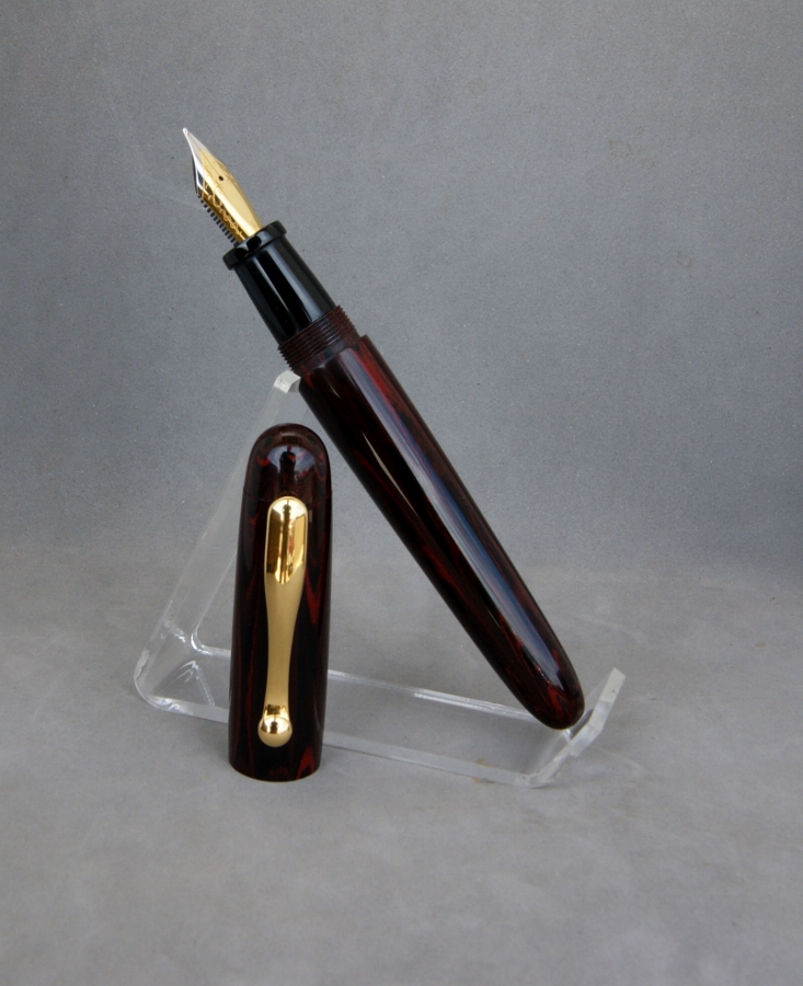

After finishing up my largest pen order I had a leftover cap for one of the ebonite pens. I know what you're thinking "How you can have any leftover pieces? It's not a entertainment center!". Well, while I was making them I was in production mode and made all my sections first, then bodies, and caps last. While making the "last" cap I accidentally drilled out to many of the cap threads to reduce the # of turns it took to close the cap. So with that the body I already had made didn't fit the cap anymore. So I set it aside and just remade another cap real quick.

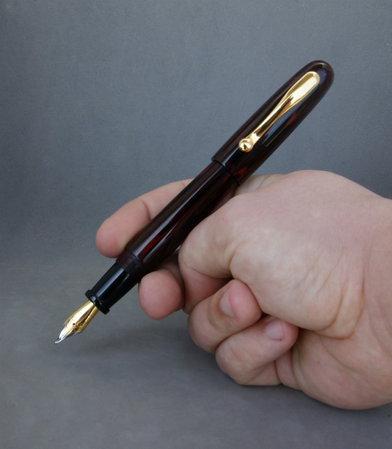

After I finished the order I really REALLY loved how nice the pen felt in the hand. So yesterday I took that extra cap and made a body to fit.
Dimensions:
Capped: 5 3/4" ~ 146mm
Cap: 2 1/2" ~ 64mm
Body: 3 3/8" ~ 86mm
Body + Nib: 5 1/8" ~ 130mm
Posted: 6 1/2" ~ 165mm
Threads:
Cap/Body: 14x.75mm Single start
Section/Body: 10x1mm
Nib & Ink:
#6 Two Tone Jowo in Broad
Cartridge/Converter/Eyedropper
Thanks for looking!!
