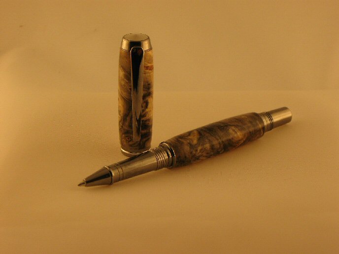

Just finished my photo booth. White nylon cover. 250 watt halogen lights on each side and the picture is worst than before. Where the %&*^$#@ did all the yellow come from?

Yep, white balance is the problem but that can easily be fixed. See this page for a brief description of WB.
Does your camera have a white balance setting for "incandescent"? If so, give that a try. Halogen is incandescent.
What type of camera is it?
EDIT: Never mind. I see it's a Canon Powershot A590. Sweet. You don't have a setting for incandescent but you do have something even better.
You have a "manual" or custom WB setting that is the most accurate way to set WB. Check page 102 in your manual.
If possible, shoot in a dark room with nothing but your halogen lights as a source. Then follow the instructions. You basically put the camera in a "preset" mode and shoot a pic of a piece of white paper. This sets the camera's WB automatically and is good for as long as your lighting stays consistent. Remember to put your WB back in auto when you're done.

White balance. your camera needs to be set for incandescent lighting for halogen lights.
you probably can get the color correction in your photo editor as well. I've never tried that one though
Next.
OOPS i sort of took your post as you wrote it but when i looked at teh photo in blown up view, the color says it could be a florescent setting you want. it has a pink to it.
with a camera on auto, you will get a yellowish brown with incandescent lights, and a blue with florescent. some types of florescents will cause this pinkish look. just try all the settings until the colors look the closest to right.
all good advice, but I wonder what you're using to process the image. I'm lucky in that I have adobe on my work computer. your image cleaned up nicely by the way.

Still, the better your original images are the less software processing you'll have to do. Getting a good white balance setting is key. You can always adjust exposure compensation but correcting improper WB is a bit trickier. Ned has done a great job on this one.
