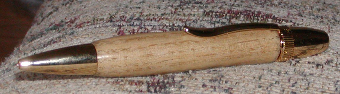

I turned my first pen today and will post a picture tomorrow. but it has a flaw, the nib end is off center. the wood is Sassafras and the kit is a Woodcraft Atlas. I no longer have the pen as I did the turning very quickly and a 3 coat finish of CA buffed to a satin sheen. It was a gift to my current boss who's last day is Saturday and today is the last day I will see him.
The nib end was turned on the outboard side. If you use a drill size guide the end is round and looks centered but when you screw the nib on one side is low and the other side is high, the clip side has no flaw I can see other than the clip being proud of both the wood and the cap.

hmmm not out of round and not a bent mandrel, the finished blank is round, and not oval, the tube looks centered within the turned blank with no gaps but attaching the nib it is like the blank shifted off center. Am I making any sense here?
I'm with Becca - I'd like to see a pic. I'm having trouble envisioning it, because, assuming you squared the ends properly and that nothing is wrong with your bushings, the barrels should always be circular - it's just a question of whether the tube is sitting in the middle of that circle or not. If the tube looks centered in the turned blank, the only thing I can think of is that the ends aren't square to the tube.

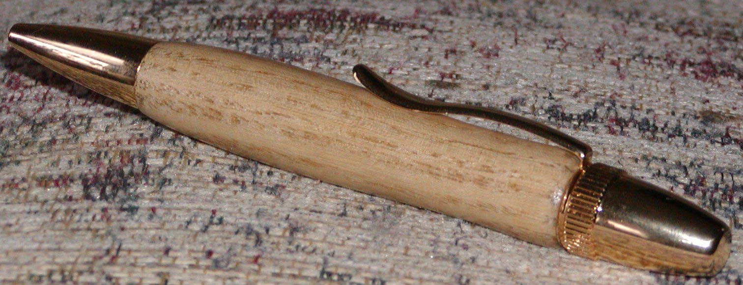

Here is my First Pen a WC Atlas with Sassafrass
The photos don't show the problem very well. will have to check when I finish my second pen and see if it happens again.
