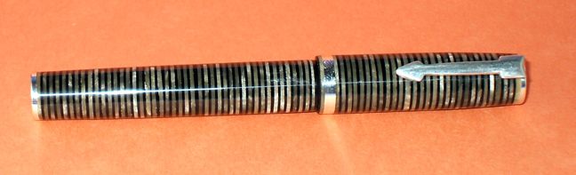

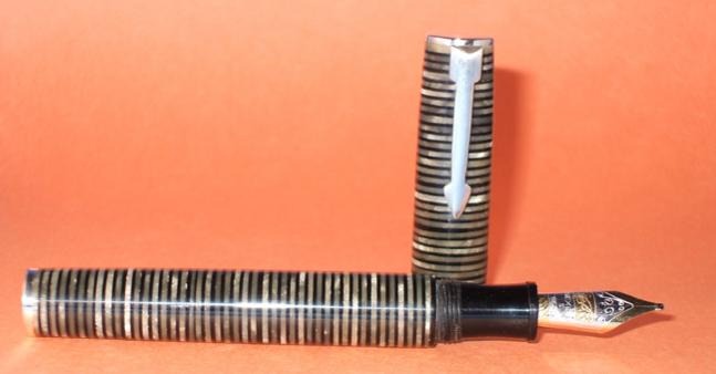

My version of a vacumatic blank with a clip tribute to Parker. Home brew PR resin sliced too many times to count, with hand fabricated sterling silver fittings. All comments welcome.

No doubt a major amount of Labour. The home brew Kit and clip look great, but I'm off on a limb by myself in that I don't like the blank. Too busy, perhaps it's all the black so close together. sorry.

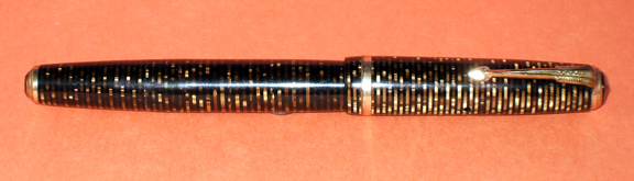

To all who commented - many thanks. To Jeff, the blank actually came out a little more busy than I hoped, but maybe it will patina like the old ones and in 50 years it will look like this vintage inspiration.:smile:

Wow, that is some serious work! Did you use the translucent amber PR so the blank was see thru like the original?
BTW, I have the same pen and color as the above Parker, but with out the tassie jewel. They are even more stunning than that photo shows.

Thanks - Mine is not translucent. Was just trying to get a similar effect. Also has a center core to keep it together so even if the amber was see thru the pen would not be. Perhaps in a different version, but I really need a better way to make these. This one fought me all the way.
What if you were able to level some plate glass and pour a thin swirled PR onto that and allow it to make a thin sheet? Maybe a few layers of masking tape to make a "dam" to keep the thickness?
Then a lightly tinted amber in the same method for the inserts. This way you might be able to cut it into thin strips, drill the holes in the sheet and then cut them apart and build it on a brass tube.
I like the pre-drill idea to keep the hole straight compared to the lines of the blank.
Make a wood board with four t-nuts in each corner, install pan head 1/4-20 bolts and place the glass ontop of that. This will allow you to adjust each corner to level. Just thinking here.
Even with that setup which is a good idea, I think it would be really difficult to make a uniform thickness sheet. This one was sliced from a turned cylinder and randomly oriented to get a similar effect to the Parker. If I cast a sheet, I think I would want to pass it through a thickness sander to make the pieces uniform, but I don't have one. The other idea is to make the colored section, turn it round, and with a thin parting tool on the metal lathe make grooves that can be filled with a second cast of black PR. The trick with that one is perhaps to make multiple pours at angles of the colored section to lose the grain effect.
