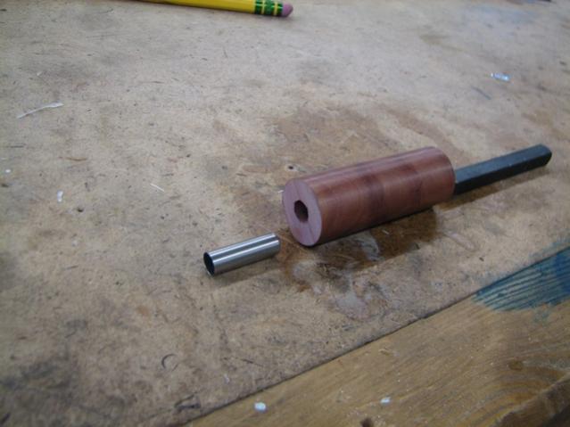

I turned a piece of wood to 3/4" and cut it 2" long. I drilled a letter "R" hole for the punch 1 1/2" deep, turned it around and drilled a letter "F" hole for the eraser cover all the way through to the larger hole. This will keep everything centered.
The punches have 1/8" tall numbers and you can find them at alot of places for around $12-$15.

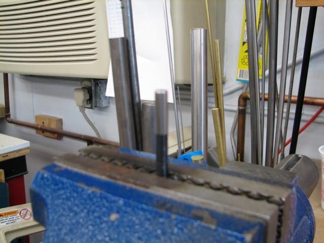

I found the appropriate transfer punch from my set and put it in my vise with the eraser cover on it.
BAD PHOTO......but you get the idea.

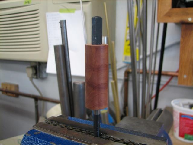

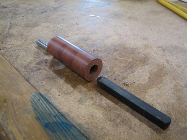

Next I put the punch in the jig and slipped it over the eraser cover....

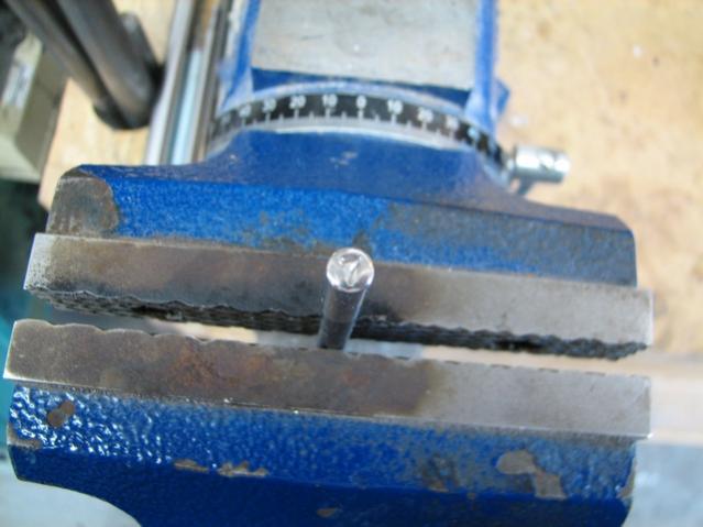

BANG, BANG, BANG...a few licks with a hammer and voila............
It works pretty slick, I like it anyway!!
