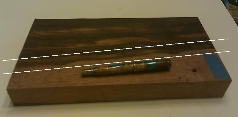

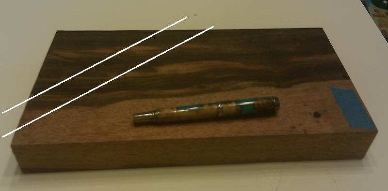

Well, certainly everyone has different opinions and that is just normal but if was me, I would be thinking on what type of wood effect I wanted for the pens, then I would be either cutting it diagonal (45°) as per pic-1 or the 2 tone, which are always my preferred choice when possible, shown the cut on pic 2. but, from the block of wood you have to work with, the diagonal cut will give you also blanks with the 2 tone just in different orientation...!

As I said, everyone has different ways to go about things and is never the right or wrong ways to do it but, certain methods/processes are more effective then others...!

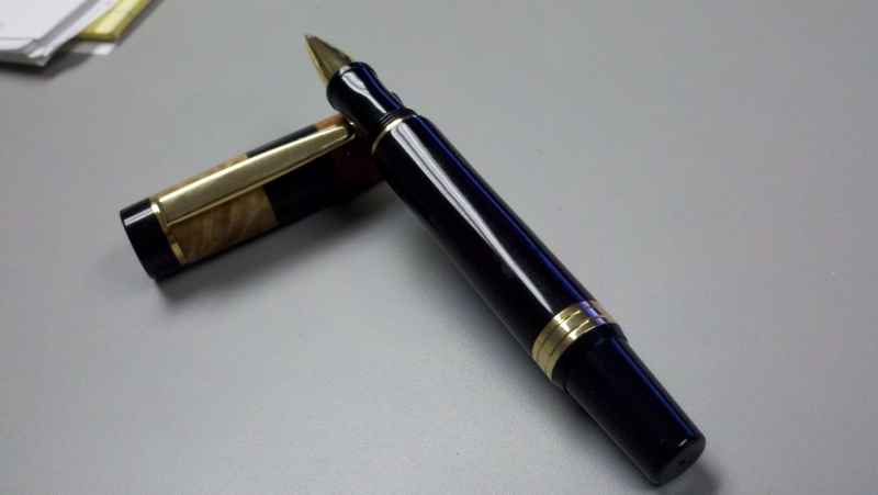

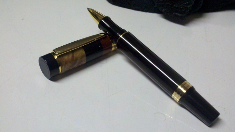

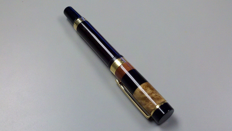

I remembered this thread and thought i would post a pen i recently did in ebony. I've done pens in ebony before this and haven't seen them crack. All have CA finishes but I've only had them for around 1 month so that isn't saying much.
For this I wiped down with acetone, thin CA, medium CA, thin CA, 400 grit up through Plastx.
It was really nice to turn (once it was round). The El Grande chunked off a little but the wood is so dark it is impossible to see the slurry of dust I put in there.
They just called it ebony at Rockler, and its black so Im assuming its Gaboon. I love how it almost looks like plastic when finished.
edit: sorry, didnt wipe off prints for the 3rd pic
