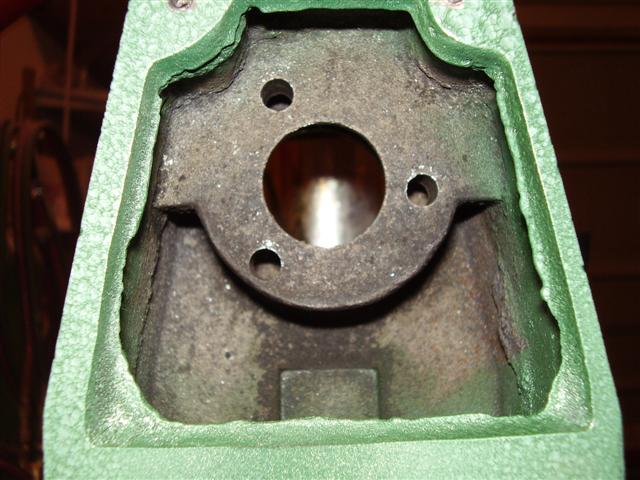

This morning I decide to work on another idea I was having, and my lathe starts vibrating halfway through. OK, I knew the bearing was going, so I take the head apart. Yep, friggin bearings are gone out. Seems the chicom's didn't clean the casting sand real good and it is all in the bearing and headstock area.

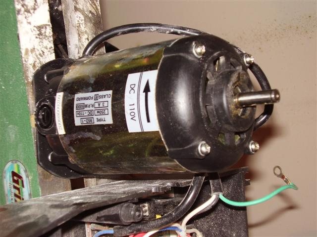

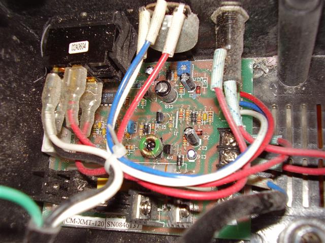

The motor is a 110 volt DC motor. It looks like a small cheap drive inside the panel with a potentiometer above the on switch to adjust the speed. It also says it is a 5000 RPM motor, while grizzly claims 4500 rpm on the spindle.

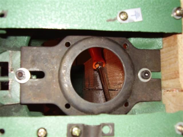

The face of the motor has 4 bolts that hold the front of the motor together as well as mounting it to a bracket that holds it in place. This bracket is slotted and allows for the tensioning of the drive belt.

This is the 110v DC 5000 rpm motor.

This is the drive, switch and potentiometer.

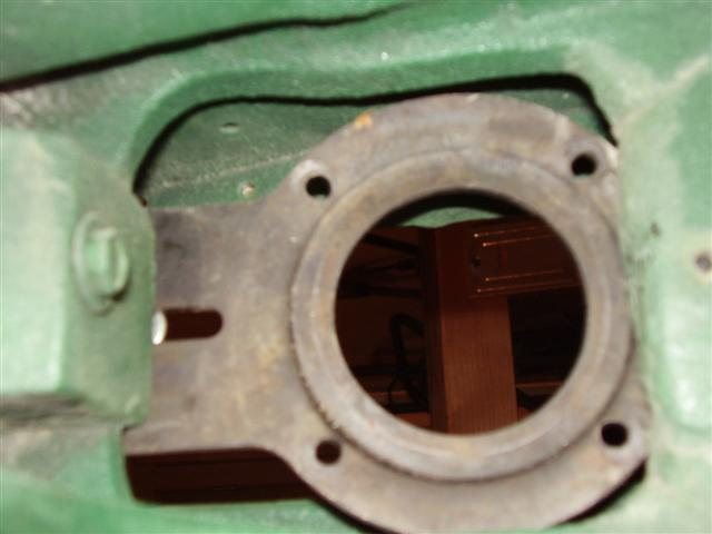

This is the motor mounting/adjustment bracket, looking from the pulley side.
<br />
This is the same as above, but from the motor side.
<br />
Headstock, from the pulley side. There is a plate to press the bushing in from the back of that.
<br />

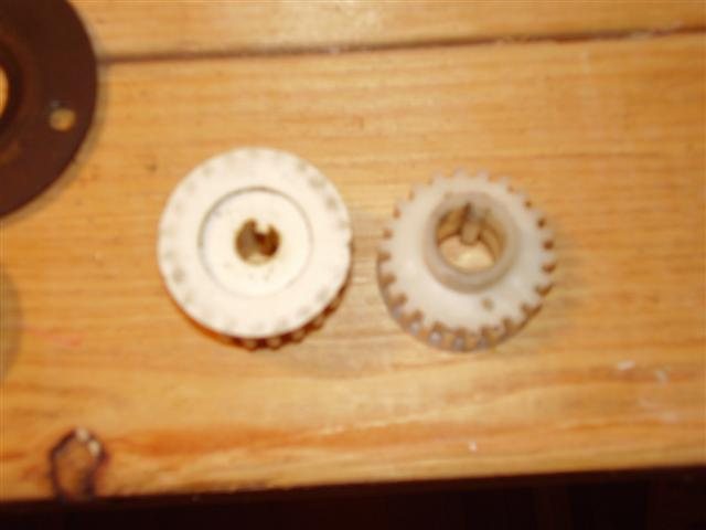

These are the pulleys. Molded plastic with the key molded as part of the pulley.

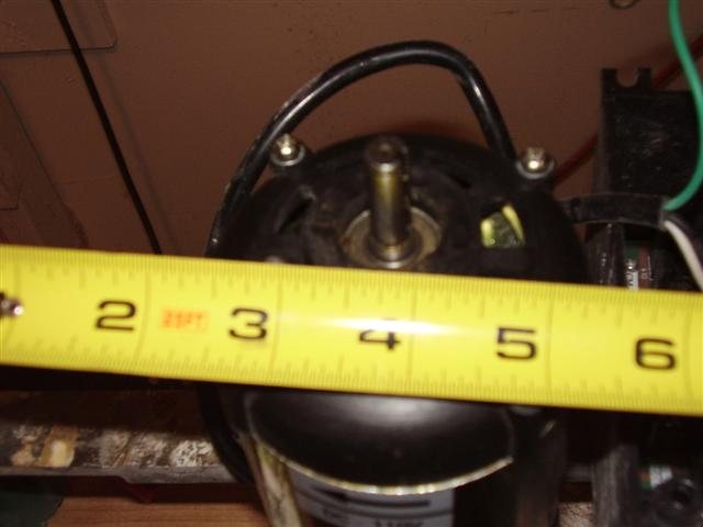

Bolts are at 2 5/32" and the shaft is 5/16".
