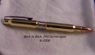

Nice work Mark. There are only two things I would like different and these are only my preferences, doesn't make them right. I'd like the centerband to be closer to the same diameter of the butt of the cartridges, and I donot care for the non-bullet nibs. You need real bullets...:wink: The streamline kit has a centerband that looks good, but I don't think they come in copper, maybe they do. Here is what the centerband looks like.

Paul, Thanks for the advice. Eventually, I'd like to do away with a CB altogether. Once I get my Collet set, I'll try using a real bullet. Until then, I'm using what I have.
