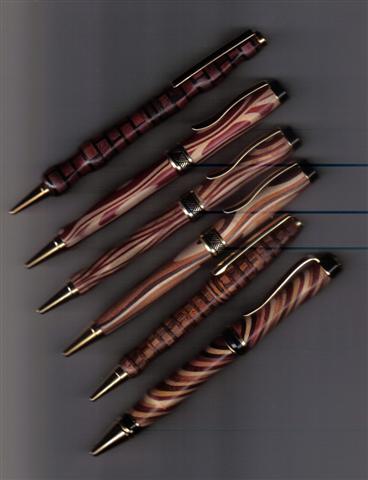

Here are a few I didn't submit for the contest.
This picture thing,hangs me up.
WOW I like those a lot, how do you do the three ,second, third and fourth from the top? As My Son and his friends would say, those are just Totaly Awsome Dude. And as I usually put it, Give it up because inquiring minds want to know.

Really Eagle, your workmanship is way to good to hide it behind your bad picture taking. I am straining my eyes to see how nice they are. The first 4 from the top really look cool. Nice job. Anthony

The BENTWOOD laminations were not my first choice for a contest entry I'm still working on that idea,
The impetus for the second third forth and sixth pens came from the article in Woodturning and Desisgn magazine ,I beoieve it was the second issue.
It containes the plans to make a fence for a tablesaw seld that could repetedly cut thin strips of wood accurately.
The strips of different woods are then glued together and cut on an angle to make a blank as in the sixth pen.
the second third and fourth pens used the thin strips but I started with a blank and cut out a shape refrenced to the center line of the blank.
I cut it on a bandsaw but a scrollsaw would work better.
Save the off cut as this is the mold and pattern for the gluing process.
The strips I used were fairly thin,some I have meassured at .0185".
glue and clamp using wax paper or a thin strip of "bread board plastic" on the last piece if you want to add to the lamination.
The 2nd and 4th pens were squared and turned and the process repeated.
I used any clamps I had on hand and yellow glue.
Hope this helps.
