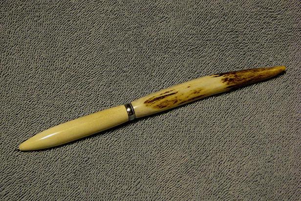

Got to fooling around today and wondered if I could make the lower barrel of an antler pen totally out of antler, you know, no nib? Since I have a closed end mandrel I got from Bill at A.S. a while back, I decided to give it a whirl.
Both barrels are deer antler tines turned on a 7mm closed end mandrel. Then the lower barrel was drilled out like a cartridge pen bullet (al la Rick's tutorial on bullet pens in the library). Added a slimline transmission & refill and a confort pen chrome centerband I had laying around to complete it all.
The two antler tines turned out to be different shades and next time I may use a custom wood centerband, but I was happy with the result for a first try.

Great job Steve, I for one think the center-band chosen works better than one from wood. I think it would be too much "natural material" and would distract from the antler. I also think the chrome is a prefect choice all the way around. Looks great!
Looks really nice. Any concern about the nib portion breaking under the stress of the ballpoint pressing against the sides?

Good question. I purposely flared the nib end wide, but only time will tell. I've decided to use this pen myself at home to see how it holds up.
