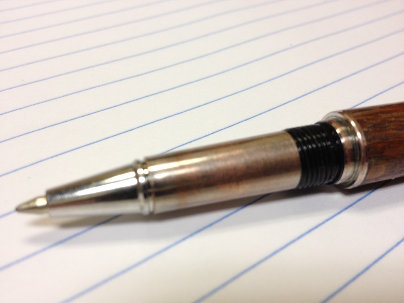

3 weeks of daily use of a Chrome Jr. Gent I. Now I dont expect this lower end pen to last forever but 3 weeks?

Are you the one using the pen??? It has been noted not that long ago here that some people have more acid in their bodies or something like that which can actually eat away pen finishes far more quickly. Maybe the person using the pen is one of those people.
This is the second pen I have supplied to the same user, the first one was used for over a year until he lost it, this was the exact same pen ( wood and kit) as the other. The other pen was still shiny when it was lost.
Where did you buy this pen kit? Have you contacted or talked with the vendor? Think should contact vendor and see if others have the same problem. Might also replace the kit if has a bad run on these kits & poor plating a problem.
Then again, Russ Fairfield used to say some people are so toxic only a Bic pen will work for them. So guess echoing what John T. said.
Of I was the vendor, I'd want to know.
I wonder if this is happening elsewhere or an isolated event?
It would make me a bit nervous about buying the kit.
I have never seen a chrome kit go that bad that quickly. It looks more like it has had ten years of hard use.
Definitely contact your supplier about the issue. (Unless you bought it from me. If that's the case, then I agree that it was operator error. One should never use such a fine instrument to stir the muriatic acid.)
That actually makes me think that an earlier poster might be on to something. What does this customer do for a living?
I have not contacted the supplier, I wasnt going to give him grief over 1 kit, he has sold me alot of them that are wonderful.
Seamus....I bet this guy was handling rattle snakes prior to using the pen
This pen is used in an office enviorment and the guy doesnt use any products I can think of that would cause this..(this was my first thought)
You know I tried once to polish a pen and the finish did come off just like that. I can't remember what the finish was but it had some CA on it but I didn't know at the time it was CA but I polished it with some auto polish and took the finish right off. I can see how a customer could think they were going to make their pen really beautiful, polish it and accidentally do this. I did report it to the supplier and he replaced it without any question. After I realized what it was I also reported to the supplier and he thanked me for my honesty. It set him at ease knowing that it was in fact my own fault not the fault of the product. I had used some CA to hold the parts in because I thought they were too loose (in my opinion. I may not have the same opinion now) but the CA didn't setup before I screwed it in but it looked more like tarnish? Well needless to say I learned something from that experience and had to thank the vendor for being so patient with me. Thanks again I am sure he knows who he is and if he wishes to reveal who he is it is OK by me. Anyway I know that polishing is not a smart move now applying wax may be OK any thoughts from you guys on the wax?
